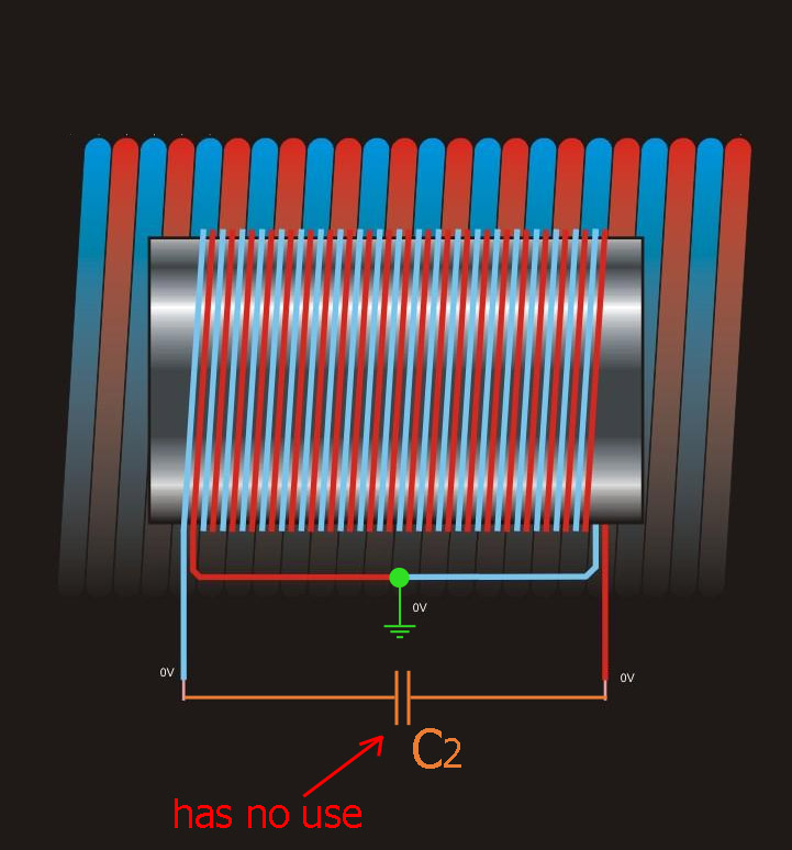

        • Your bifilar resonating coil is it wound and connected like the attachment below?
          In this thread somewhere there was a statement about the ground forcing a node. Since your bifilar coil is one wavelength long and you force a node in it's middle it means nodes will form at the beginning and end as well. This will cause 0 voltages on both these ends, so it has no use connecting a capacitor or even the ends together. Or am I wrong about this?
          • Is there a reason why you're using the term "bifilar" then. It seems you have one 1/4 wave primary and two full wave secondaries left and right of it. bifilar refers to a way of winding and hooking up a coil, usually by winding a turn of one coil between the turn of the other coil like illustrated above. And also with this correction of yours my remark still stands. Since the "bases" of the secondaries are at 0 volt and they will force a node of the standing wave, which also means nodes will form at the ends of the coils. Thus there will be no voltage there.
            • I don't get the whole theory behind why or how one generates voltage and the other current or how it becomes a 1/4 wave resonator while it has a full wave length. Because tesla used both 1/4 wave length for primary and secondary.*
