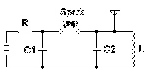

        try to learn more about induction coils. u will see how pulsed dc is used to induce ac in secondary coil.
        2nd thing is when pulsed dc is fed in parallel Lc combination it oscillates at its Lc frequency. understand below

              I tried 600-230v iron core transformer by using this setup, it didn't work for me. Still thinking why.
              • Originally posted by Garsony View Post
                coz u tried iron cored for rf. try ferrite core or toroid. if u had rectified and then used dc then u can use iron cored trafo.

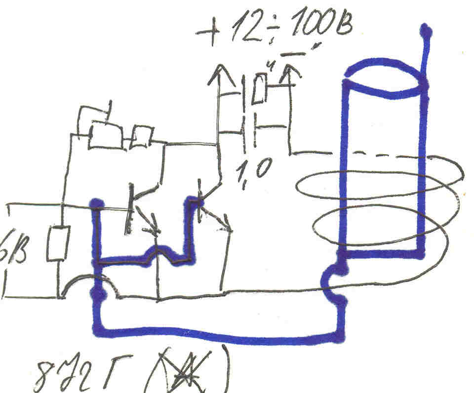

                        • Originally posted by DilJalaay View Post
                          Hello Sergey,
                          I redraw your schematic(attached).
                          Can you please specify the red mark values.
                          i.e: transistor?
                          primary/secondary coil length/dia etc.
                          As seen one end of the secondary coil is directly connect to the base of the transistors, is it not blow the transistor?
                          Regs,
                          D.J
                          Hi,DilJalaay!
                          Nice design!
                          unfortunately you did The mistakes in the circuit.
                          So I understood that you are not so experienced.
                          In this case i'll try to paint an other circuit (more useful for starters)
                          What about this one(see the attachment)?
                          If it is clear enough I'll make a description in eng.
                          This circuit can work with most common transistors. Tell me please what kind of transistors do you have?
                          You should use transistors V= 300 ore more and I= 10A ore more.
                          Also you can combine them(the same transistors in parallel)

                          • Thank you Sergey, now it is clear. Am going to arrange my components now. B.T.W am using 2N3055 trans, will contact you soon if i further need your help.
                            Regs,
                            D.J
                            [email protected]
                            • Hello, Sergey!
                              I have approximately the same questions, why don't you answer them here with clear schematic, because your other one left a lot of questions( esp. about toroid, how its wound and connected), and I want to replicate it.
