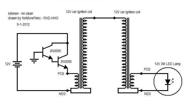

Its great to hear you say that man, you know your stuff, yes when i first came across this design idea, i ran it thru 2 Imhotep lights AND a spark gap...then running back to its own positive, with an antenna wire on neg terminal, it went from 12.08v and after 3 days it was 12.31v ...and it held...Originally posted by Farmhand View Posthey mr clean,
using the transistors like this for an oscillator is a trip dude.

Oh, I'm not sure but a regular grounded scope might not show the oscillation
or stop it so I just used the little isolated one.
BUT removing the load or sparkgap would "snuff"it out as you said
dont worry about self-running just yet, that will come to us, but do use one up coil and one down coil, and then no matter what condition the output coil + - is in (open, full load or shorted together) will not phase the input.
Just watch out not earth ground the load, AMPS will come flying at ya, but as much virtual ground (ie air or long length of wire) will help brightness, as much virtual ground can be used as possible without raising current draw.
JUST add the antennas after you jump-start it, any grounding other than base will surge current to ground, so add the virtual grounding after its running, and watch current draw as you add antennas, you could keep adding air grounding until you notice it is drawing something
But DO earth ground the base! very stable operation.

Thank you. do I need RF filter toroid to run it on 12V ? KT805 can be replaced by MJE13009 ? with tv flyback what about connection to base of transistor ?Originally posted by usu View PostOf course!
See Ganzha post above .
Sergey.
do you have schematic how to use katcher with tv flyback ?

NoMorePetro on youtube kindly wrote this...
1F x .5 x 12 V squared divided by 3 Watts gives you 24 seconds
and it went for 208 seconds!!!!!!!!!!!!!!!!!!!!!!!!!!!!!!!!!!!!!!!!!!! !!!!!!!!
The issue is that the bulbs go forever, so i did a 1 minute run time, and checked brightness at end of 1 minute running on a 1 farad cap....
Guess what the results were....

Have you tried another current meter to measure input ?Originally posted by mr.clean View PostAWESOME idea man, do it! the ignition coils were just convenient as they are contained and such... but a better core able to go up toward 100Mhz and withstand 24, or higher voltage input would ONLY be better in every way.
I think your meter must be broken, can you try another one and show the
input then ? I'm not complaining but it might pay to check, just to be sure.
I have an analogue current meter that won't react until about 400 mA is
flowing through it so it gives "under readings" it is damaged by shorting I think,
I could demonstrate it when i find it.
I think your basing calculations on assumed levels of output power as well. Did
you measure the load power. Use the same meter for that if you only have
one, you could take it off the input and put it on the output.
I'm not making any accusatons or anything I just think you should double check is all.
Also can you scope the ground lead to the transistor base unconnected ?

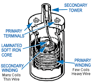

standard ignition coil
Here is some info on standard automotive ignition coil.
The ignition coil is nothing more that an electrical transformer. It contains both primary and secondary winding circuits. The coil primary winding contains 100 to 150 turns of heavy copper wire. This wire must be insulated so that the voltage does not jump from loop to loop, shorting it out. If this happened, it could not create the primary magnetic field that is required. The primary circuit wire goes into the coil through the positive terminal, loops around the primary windings, then exits through the negative terminal.
The coil secondary winding circuit contains 15,000 to 30,000 turns of fine copper wire, which also must be insulated from each other. The secondary windings sit inside the loops of the primary windings. To further increase the coils magnetic field the windings are wrapped around a soft iron core. To withstand the heat of the current flow, the coil is filled with oil which helps keep it cool.
The ignition coil is the heart of the ignition system. As current flows through the coil a strong magnetic field is built up. When the current is shut off, the collapse of this magnetic field to the secondary windings induces a high voltage which is released through the large center terminal. This voltage is then directed to the spark plugs through the distributor.Rick

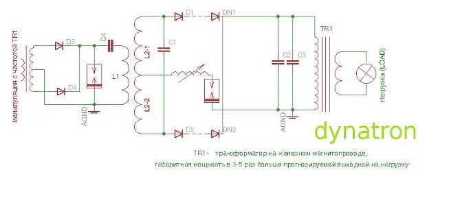

Anyone can make any accusation, but without evidence, that is all it is.Originally posted by dyatronn View PostВсем привет, вы меня конечно, извините.....
но, Зилано дурит Вас......, я в английцском языке не силен, но у зелины нет и ничего*быть не может, - это все обман.!!!! !!!!!!
Это поиск лохов....
DynatronRegards,
VIDBID
Originally posted by baroutologos View PostI have been devoted past week at studying Donanld Smith's devices and theories.
This man seems serious and claims that overunity or an extraordinary energy gain can be achieved with moderate means.
One device illustrated, and as claime, it was presented at a Tesla symposium, it was the image below.
Don Smith claims that a high frequency alternating current could be modified in frequency by the application of a resistor, a capacitor or perhaps a coil (choke) wired in parallel to the initial HF source.
Does it tell anything to anyone that? Is it makes any sense? That illustration uses a 12 volt powered Neon Sign Transfromer to charge 8000uF caps at 400 volts or so.
LOL? how the... can it be? Is the man heavily miscalculating or is there any explaination to this?
Baroutologos
My friend if its true you'd see it on the market RIGHT NOW being used. Other than that its all BS.
If it's the dynatron with the Don Smith replication thenOriginally posted by vidbid View PostAnyone can make any accusation, but without evidence, that is all it is.
he's been working on this stuff for quite a while. And has put considerable effort
into a very good replication of Don's device. But I think it still under performs as
to what Don claimed despite Dyatronn's fine efforts.
Is Dyatronn making an accusation or a statement ? I don't get a very good
translation.
Oh, she's back, i'll get first row
And "without evidence" all her statements just a farce.Originally posted by vidbid View PostAnyone can make any accusation, but without evidence, that is all it is.
Or we ask too much? Just show your "using" device and teach us as much as you wish, we all ears.
Changing others schematic don't do any good.
