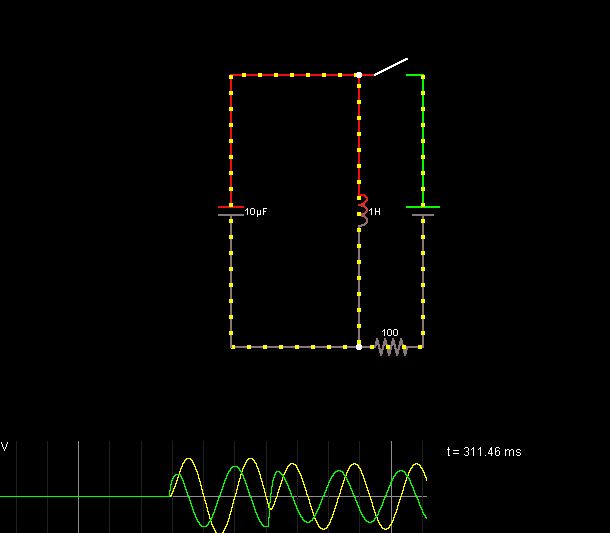

Originally posted by mr.clean
Use another spark gap on the 2000v battery and step it down.
In the beginning, you turned your nst into DC pulses to charge a cap to a DC charge. Then when the cap is charged enough it jumps the gap and bounces back and forth between the coil and cap at a certain frequency (the resonant frequency) until the energy is no longer there to support the spark so the bounce stops and the cap is recharged by the nst and the process repeats. Well, you already have a 2000v cap (battery) use that in another resonant coil combo to drop the voltage down. During this bounce though, the capacitor is an AC cap, when the cap discharges into the coil and emits radiowaves then bounces back to the cap the polarity is now REVERSED. So if you step it down this way, make sure your "battery" can handle the AC that you will be throwing at it. I have no other ideas of how to do it without REALLY expensive sh..stuff.
I might have other ideas if I get to that point.
