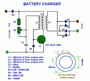

                  The schematic I am currently using for my lv HF is this one with BD243C transistor instead of the one Groundloop used: (attachement)
