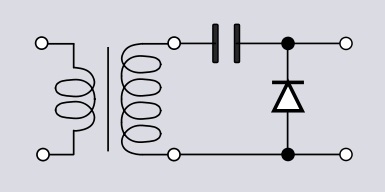

        Hello All,
        Has anyone experimented with pulsed DC to a capacitor?
        I think and tried it and the cap got hot and exploded.It was an electrolytic @400 v with 119 volts 50 hz applied.
        I attached a diode bridge to the capacitor.What happened? Too much current or overvoltage?
        What are the ways in which this explosion could have been prevented?
        Best regards,
        Ged
        • Originally posted by Gedfire View Post
          Hello All,
          Best regards,
          Ged
          Most likely overvolt.
          C1/D1 is a voltage doubler circuit so the output from it is a peak 333v.
          And the 400v capacitor cannot handle it with high current when it is initially empty and charged.

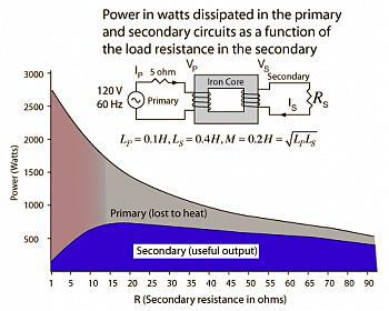

          • Originally posted by level View Post
            I am not sure what your point is, as I fully understand that RMS values can be determined by the amount of heat being produced, and at least some better quality true rms meters use a method similar to that. Anyway, for your example, if the source is say 120VAC and the current through the 10 ohm resistor is say 0.25A, we will be dissipating 0.625W in the 10 ohm source resistor R1. If the resistor is a 10W power resistor, it will likely not be too hot. If the black box contains a step down transformer, and steps the voltage down to say 24VAC, and let's say the load equals about 10 ohms as well. Then we would have 12V across the 10 ohm resistor R2, giving a current of 1.2A. The power dissipated by the 10 ohm resistor R2 would be 14.4 watts. If it is also a 10 watt resistor, it wouldn't take long for the resistor to over heat and maybe burn up and fail. So, you don't need another source in the black box. Just a transformer could produce exactly this sort of results. Again, not sure what your point was with that.
            In the example, you can not arbitrarily isolate the input from the output; even when a transformer is assumed to be in the Black Box; consider the overall circuit in-toto [for your example: a quick "ballpark" using I=V/R & P=V*I yields Pri = 1440W, Sec = 57.6W (assume a loss-less transformer) ???, yea I know it's AC & ... but we're just "ball parking" it for quick logic].

            • Originally posted by Solarlab View Post
              Hi Solarlab. Your calculated numbers don't make sense to me. Although the measured numbers likely wouldn't come out exactly the same with a real transformer circuit setup due to real world losses, I was just throwing out some example numbers to illustrate that this shouldn't be anything unusual. In my example, assuming a power factor of 1, the input power to the transformer would be 0.25A x (120V - (0.25A x 10 ohms)) = 29.375 Watts. The power delivered to the load would be 1.2A^2 x (10 + 10) = 28.8 Watts. That's an efficiency of about 98%. Nice efficient transformer.
              No idea how you came up with those numbers of 1440W in and 57.6W out, but you obviously are making an error somewhere. With a supply of 120V and a current of 0.25A in, it should be obvious that your calculated power numbers don't make sense. Assuming a power factor of 1, it is basic ohm's law and basic power calculations. Anyway, I don't want to distract too much from the topic at hand which is Don Smith devices. If you still have doubts, you can always setup a test circuit with a 120VAC to 24VAC transformer and a 10 ohm series resistor in the primary and two 10 ohm resistors in series in the secondary, and measure for yourself.

                Hi Ged. Your full wave diode bridge rectifier is not shown connected up properly in your attached circuit diagram. If you connected it up as is drawn in the circuit diagram, you would be getting a near dead short across your AC source on negative swings, depending on what the actual capacitance value is for C1. If C1 is a small value, it should be OK though. Is that how you actually had everything connected? Anyway, if you did not connect your fullwave bridge rectifier up correctly to an electrolytic capacitor such that it wasn't always getting positive DC to its positive lead and negative DC to its negative lead, this can make electrolytic caps explode. You need to be careful with that as an exploding cap can be dangerous. Also, what type of capacitor were you using for C1, and what is its voltage rating? Was it C1 or C2 that exploded?
                  No it's not a dead short. It's a Villard circuit.
                  On the negative swing it charges the C1 cap and on the positive swing it puts the charged cap in series with the AC source effectively adding to it's voltage.
                  The peak to peak is still the same but the positive peak is Vac x 2 and the negative peak is 0volts.
                  • Originally posted by janost View Post
                    Yes, it wouldn't be a short if you are using a small value for the capacitance, as I mentioned. If a very large value of capacitance is used it would act more like a short, but then you would pop a breaker or blow a fuse if the current draw was too high. Gedfire didn't mention what value he is using for his C1. Also, Gedfire mentioned a 'diode bridge', so I was assuming he was intending a full wave bridge rectifier setup. The way he has it connected in now would not be a proper full wave bridge setup, but maybe that is how he intended it. I wouldn't think that 340V peak would cause a 400V electrolytic to get damaged, but I haven't played around with circuits like that, so not certain. Maybe there is something else going on there. Accidentally hooking up an electrolytic capacitor backwards could definitely cause it to explode though, especially at those kind of voltages.
                          It doesn't matter what value you have on the C1 cap.
                          It's a singel stage voltage multiplier.
                          Voltage doubler - Wikipedia, the free encyclopedia
                          And it acts like one of the quadrants in a fullwave rectifier bridge with a smoothing cap after it.
                          C1 could pop if you draw above the C1 ripple current rating but that is a differnet story.

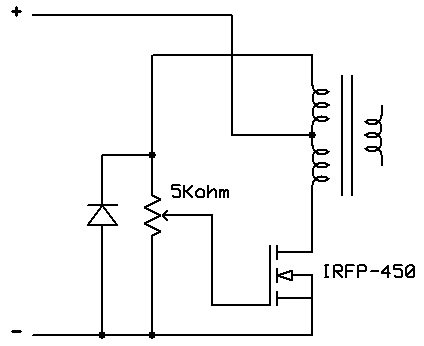

                                By the way, did the voltage divider help at all with your FET joule thief circuit?
                                Something like this would move the switching point for the mosfet?
