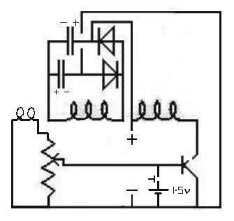

            • hi janost.i got a bit more return out of this arrangement.it just needs a push on s1 to start every time. btw have you played with that magnacoaster setup at all?
                        Hi,
                        Seems a clever circuit, thanks for showing it. Anything you may wish to tell?
                        Thanks, Gyula
                        • hi gyula. i got a ferrite core,out of a radio about 4 " long.4 layers of .8 mag wire. first 2 for drive and 3 and 4 for collection.use varying lengths of heat shrink or tape for a permanent winding identifier because i got 8 wire ends. t1's collector goes to layer 1 in. lyr1 out goes to lyr2 in. lyr2 out goes to +. anode to cathode diodes go to 3 in. 3 out to 4 in. 4 out to both caps. a ferrite core gives a better return than air core for me so far, but just about any sort of coupled dual winding should work. caps are 250v x2 style met.poly,2 uf. diodes are fast recovery,.3 v drop. t1 is npn,has a hfe of 240 5v b-e, only about 50v c-e. probably want more than that. feedback/tickler coil is a 2 lead choke. ferrite core maybe 60-100 turns on it.you see them in smps. coil is about 9 mm by 12 mm in the winding.havin said all that just about any coil should do it.i put it close to one end of the ferrite rod. adjust vr1,100k to about 85k off the - rail and press a momentary switch to switch on t1. come to think of it the switch should go between + and the top of vr1.scratch that. it starts and tunes easier with the schematic setup.(guess its got 2 batteries then.something to work on.) :+) once started then adjust vr1 to tune.if it won't start try swapping the tickler coil leads.
                          i still want to credit janost for showing how simple a looped 1 battery circuit can be.

                            • Hi hotrod68r and janost,
                              Thanks for the details, they are clear and understandable. While I am wondering what you really meant by "i got a bit more return out of this arrangement", with respect to what did get a bit more? LOL it occured to me that you could use a tuning capacitor across the collection coils (3&4) to make it parallel resonant at a frequency. I mean a rotoverter-like tuning method where the tuning capacitor is split into 3 parts and there is a certain ratio between them, see this schematic here from this site ( merlib.org/tag/rotoverter )
                              You can see that the main tuning capacitor is C1 and there are two smaller C2 and C3 for the diodes, the relationship between the 3 caps is:
                              (C2+C3) is equal or smaller than 0.618*C1
                              You have the two 2uF metal poly caps now for C2 and C3, so C1=4/0.618=6.47uF so roughly a 4.7uF and a 2uF poly cap in parallel should be ok for testing. (Originally these caps resonate two coils of a 3 phase motor on the mains frequency 50 or 60Hz but now with this circuit it does not matter much where the resonant frequency comes about, it will still be an oscillator.)
                              With this splitting caps method, a chance is given to utilize energy circulating inside an LC tank circuit and using part of for supply voltage.
                              What do you think?
                              Thanks, Gyula

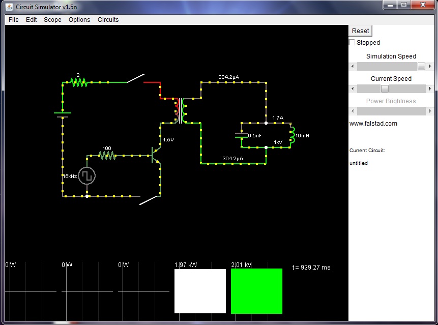

                                I wonder if this circuit is simulating what you are describing. Such a fascinating subject indeed.
                                The numbers to recreate this circuit is in the PDF if anyone is interested.
                                Java circuit simulator
                                Circuit Simulator Applet
