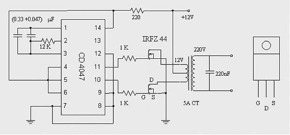

        • Hi T-1000,
          What frequency do you want the inverter to operate? If in the wideband audio range then you have to build or buy an audio-type power transformer I am afraid, because the normal laminated mains transformers work up to maybe 100-200 Hz only, there are hypersil cores working up to the some kHz range and there are the permalloy core (very expensive) transformers mainly used in old professional audio amplifiers etc up to several tens of kHz. Hi-Fi audio transformers may go up to 20-30 kHz but also expensive.
          IF your AC output frequency involved is only 50 or 60 Hz, I show you a schematic RomeroUK used a few years ago, I found it on overunity.com if I recall correctly. The push-pull drive is a must because of the symmetrical DC magnetization of the cores, this circuit has its own RC oscillator in the CD4047 and it can be made adjustable of course by a potmeter, the limit is your transformer core capability (the RC components values are for 50 Hz now and the transformer shown in it is an off the shelf mains transformer with center tapped secondary, used backwards). I know this does not use your SG though, but the inner oscillator of the CD 4047 can be defeated/inhibited by an outside clock input of course (you need to match the bipolar SG output to a zero to positive going output). Your IGBTs can of course be used instead of the MOSFETs.
          Gyula

            • Originally posted by gyula View Post
              Hi T-1000,
              The core is on very high permability - 5500, so frequencies 1-130kHz mostly. I am looking for wide band range for finding best frequency ranges and resonance. Also I would use same circuit for different purposes.
              Cheers!

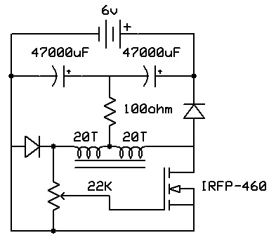

                            • I have now perfected the Mosfet JT to an extremely efficient feedback circuit.
                              I added a ferrite core to the coil.
                              It still runs at 150KHz+
                              2 capacitors are used instead of 2 batteries.
                              They are configured as a capacitive voltage divider.
                              This makes it possible to loop back the positive kickback aswell without shorting the coil.
                              It runs even if I disconnect the battery.
                              The question is for how long?
                              I think it would benefit from more turns on the coil.
                              40turns is a bit low.
                              • Hi janost,
                                Increasing the number of turns is a good idea, and consider making some taps on both coil halfs if you can to have a more flexible test range (matching).
                                Also if you happen to have some more high capacity electrolytic caps, parallel them with the single ones to decrease ESR (eqvivalent series resistance), this can decrease loss. Very good job!
                                Gyula
