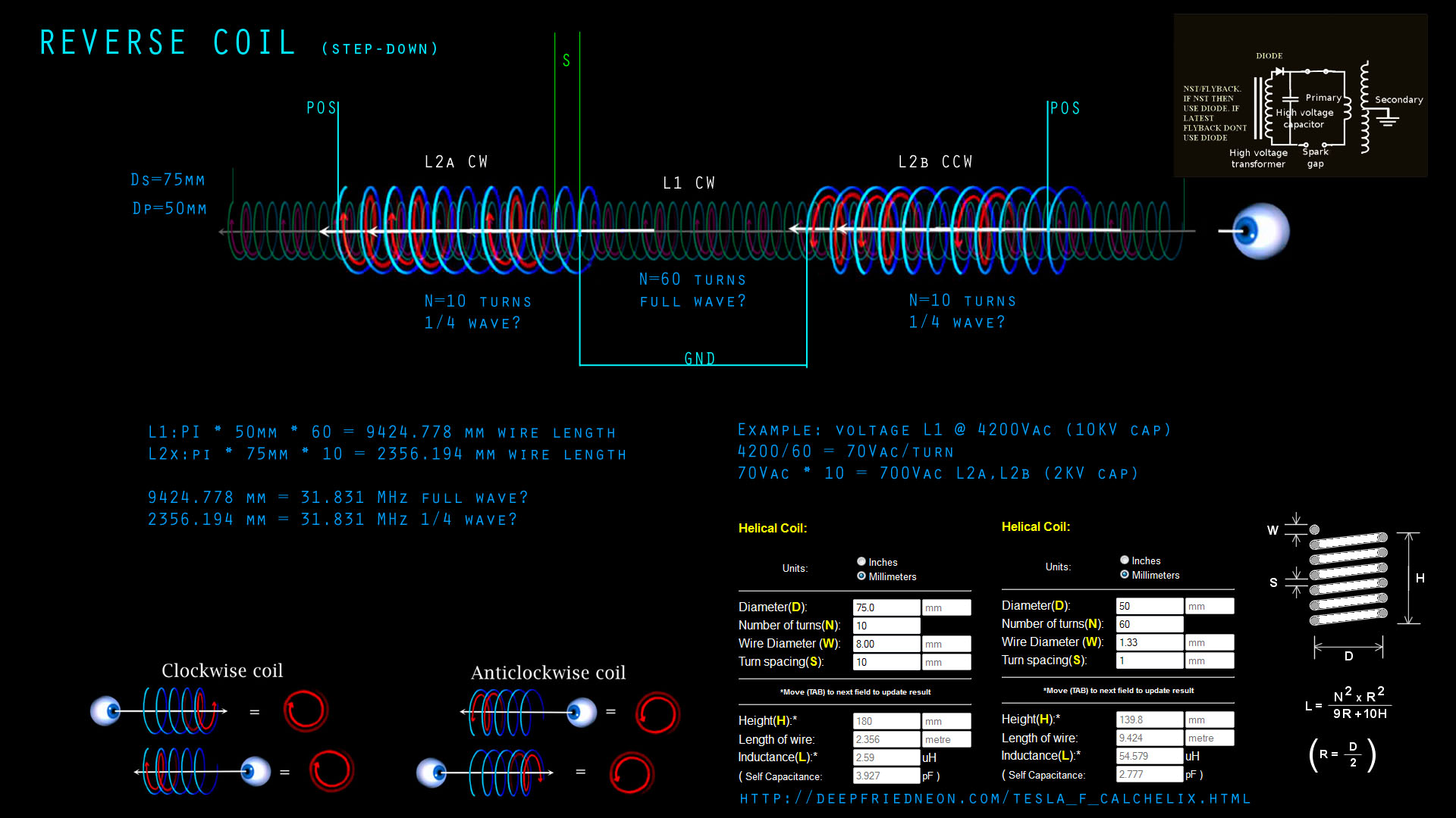

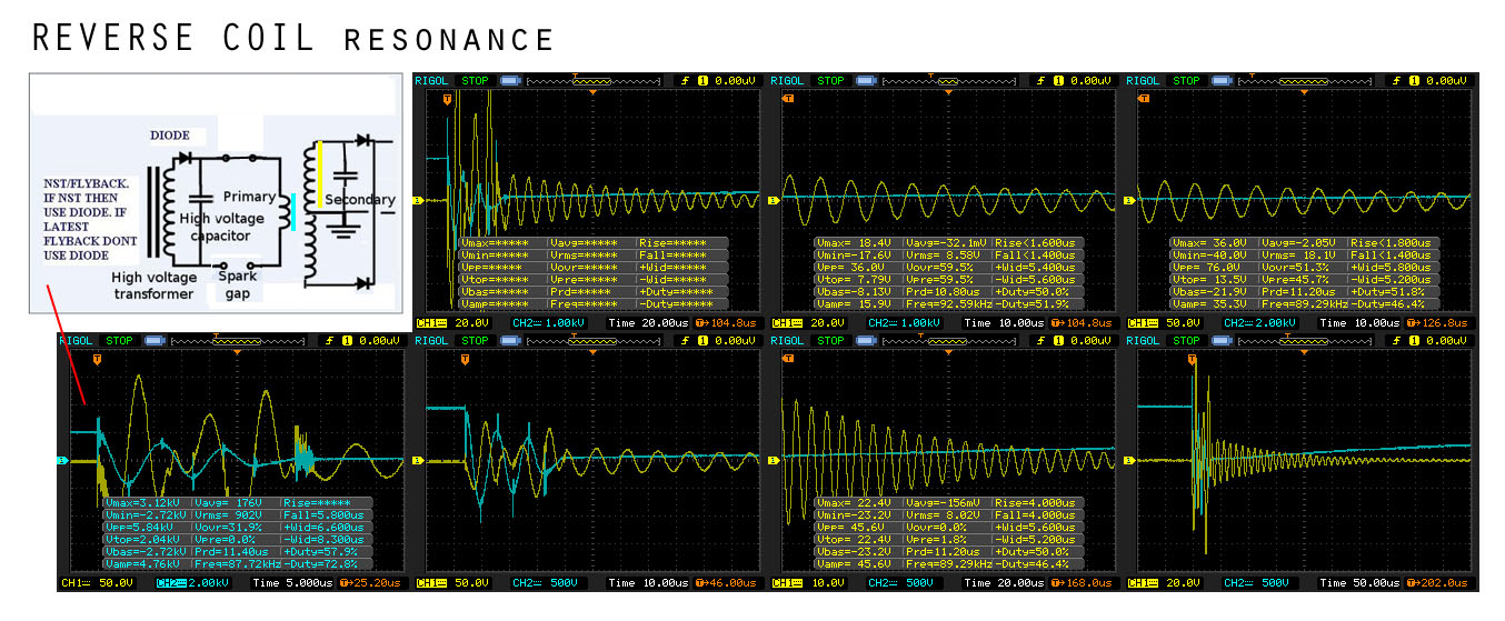

                  • Thanks for the reply, Farmhand!
                    Well I'm in the design phase at the moment...so these are the coils I want to make resonant...
                    See attachment for coil details...I hope others can help too!!! In this thread I see all kind of different types of setups / circuit, but not what Don Smith have shown us.
                    As calculated above, the coils lengths are wrong. Length is (PI * D * turns) anyway this now gives the frequency of the wire about 1/4 wave at 8MHz.
                    I still have no idea on what frequency to tune the coils... If the L1 should be 1/4 wave length then the L2s should have 4 times higher frequency ??
                    Full wave L1 is 32Mhz and L2s 128MHz, L2 1/4 wave is 32MHz?
                    So calculated backwards, the output voltage I want is 350Vdc.. min needed for the inverter to generate 230Vac/50Hz so at L2 10 turns should give 700Vac before diodes and 70V/turn from the L1 times 60 gives 4200Vac. Thus the HV dc module generate at least 3KV dc impulse voltage low current at high frequency typically 31kHz.
                    About tuning the coils, indeed all the coils have a different resonance frequency in practical world and the wire leads inductance capacitance must be included to have resonance (diode/ leads etc.)
                    The caps are needed to compensate, but I have trouble finding the right ones (capacitor tolerance) to make it resonate. (all connected wires should have almost no resistance/capacitance/inductance)
                    SO ALL BUILDERS WHO NOT USE THESE TYPE OF WIRES HAVE A HARD TIME FINDING RESONANCE!!!!!!!!!!
                    How to tune L2 on L1 with use of the spark-gap ????
                    Any ideas...scope shots...etc.
                    LC Resonance Frequency Calculator at WhatCircuits.com
                    FREQUENCY & WAVELENGTH CALCULATOR
                    Helical Coil Calculator
                    Br,
                    Cognito

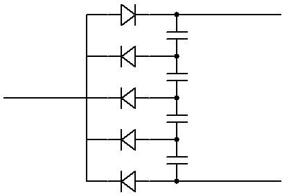

                        Yes but does the power come from the battery?
                        With one plug it does but with 2 plugs or more, will it load the battery with the same current?
                        I dont think so.
                        With 100 plugs it shortcircuits the battery or?
                        No way.
                        • Originally posted by cognito View Post

                          Hi Cognito, Yes I agree many do find it difficult to get resonance, myself
                          included. I haven't tried the resonant step down in this way as yet myself
                          either. But I do have a very similar L1 coil to yours already wound, the
                          difference is mine is separated in the middle so I could tap it if I wanted to.
                          The gap in the middle lowers the inductance and raises the res frequency
                          from what the calculator says. No matter. It has 2 x 20 turns of 2 mm wire with
                          1 mm spacing.
                          By the way thanks for the link to the helical coil calculator, Awesome !
                          I can and will show some scope shots with some of the arrangements in the
                          sketches below. I will make two 10 turn L2-L3 's.
                          The way I see it when the center tap of the two 10 turn primaries is grounded
                          it makes two 1/4 WL resonators and being opposite wound they will be "in phase".
                          As you point out you already know that.
                          Anyway we want to do is what a Tesla coil does but in reverse so we need the
                          L1 to be resonant at the same frequency of each one of the 10 turn L2-L3's.
                          Basically L2 is a pair of parallel resonators.
                          Tesla coil tuning video tutorial.
                          Tuning A Tesla Coil with an Oscilloscope - YouTube
                          There are different ways to get the L1 resonant at the correct frequency.
                          See attached sketches. Same with the output coils.
                          P.S. Doing the step down with a resonant receiver in single ground wire mode
                          is different. The receiver L1 has a cap on top and is ground connected but
                          the output coils are not grounded.
                          Resonance is fun fun fun !

                          • Looking at your circuit drawing (1) I see two caps at the secondary coils...
                            Is this cap needed?
                            My view is this: the L2a with a cap is the resonance sustained coil.
                            It has higher voltage than the L2b coil since this is a pickup coil. What frequency the L1,L2a generates the L2b picks-up at lower voltage (amps??)
                            Question: where should the cap be placed into the L2a CW or L2b CCW coil?
                            What is the volts coil and what is the amps coil: CW or CCW and from what side of the coils are we looking? Is the L1 coil CW or CCW?
                            I also have already build coils to do some measurements... also tested different kinds of spark-gap arrangements and never could resonate the L1 with the circuit Don Smith had used with the step-up coil setup. (pulsed DC from HV module to L1 and cap par over L1 and spark-gap in series at the bottom to gnd.
                            I used the same circuit (1)..see my scope shots...
                            I build a primary L1 87 turns and two secondary coils L2a, L2b 7 turns center-tapped to ground and used different caps for resonance at L1 and L2a coils. But none had the same frequency I calculated...lol
                            Br,
                            Cognito

                            • I'm thinking about something like this:
                              A super Avramenko.

                                Hi Cognito, No you don't need it if you don't want it, but that coil won't be resonant.
                                I can help you with getting resonance. But as far as all the theories of Don
                                and Zilano ect. I can't help with.
                                Feel free to try it.
                                That primary circuit of Don's won't work as it was shown in the drawing demo
                                device. Not in my opinion. There is no capacitive discharge. The L1 coil
                                would only be very weakly excited with that circuit.
                                My preference would be circuit number 3 in the top right hand corner of my
                                sketches, the L1 and C1 need to make the desired res frequency. But the L4 and
                                C1 should be a harmonic of the L1-C1 relationship, I think. Anyway L4 should
                                have enough impedance reactance and DC resistance so that the smoothing
                                cap does not discharge when C1 discharges.
                                Circuit 1 should work OK as long as the input current is limited.
                                A good page here on resonant charging circuits.
                                DC Tesla Coil design
                                Uploading a video soon to show some wave forms.
                                I used 3 turn CW and CCW output coils and a 40 turn L1 with a gap in the middle. The frequency was about 750 kHz and the L1 at 58 uH needed 0.75 nF,
                                while the 3 turn coils at 1.59 uH each needed 30 nF each.
                                I'll check and see what the two 3 turn coil wave forms look like when only one
                                has a capacitor on it.
