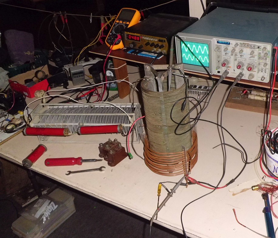

Here's the arrangement for testing for resonance using a function generator. The L2 and C2 coils are in parallel, being driven by the function generator through a 10K ohm resistor. This produces a fairly sharp voltage peak right at resonance as you tune the function generator. This is because of the high impedance of the parallel LC tank circuit formed by L2 and C2. At exact resonance, the capacitive reactance and inductive reactance exactly cancel and it appears as a high resistance, proportional to the tuned circuit Q.
https://gateway.ipfs.io/ipfs/QmUu3QE...j/IMG_1540.JPG
Here is the scope and function generator being used to tune for resonance. With the C2 cap fully closed (maximum capacitance) the resonant frequency is right about 680 KHz. To tune down to 500 KHz to match the L1/C1 side, we will need to add a fixed capacitor in parallel with C2. I haven't yet calculated how much this needs to be, but probably around 500 pF as a first guess.
