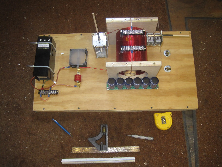

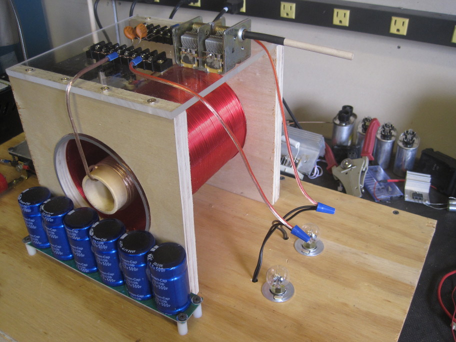

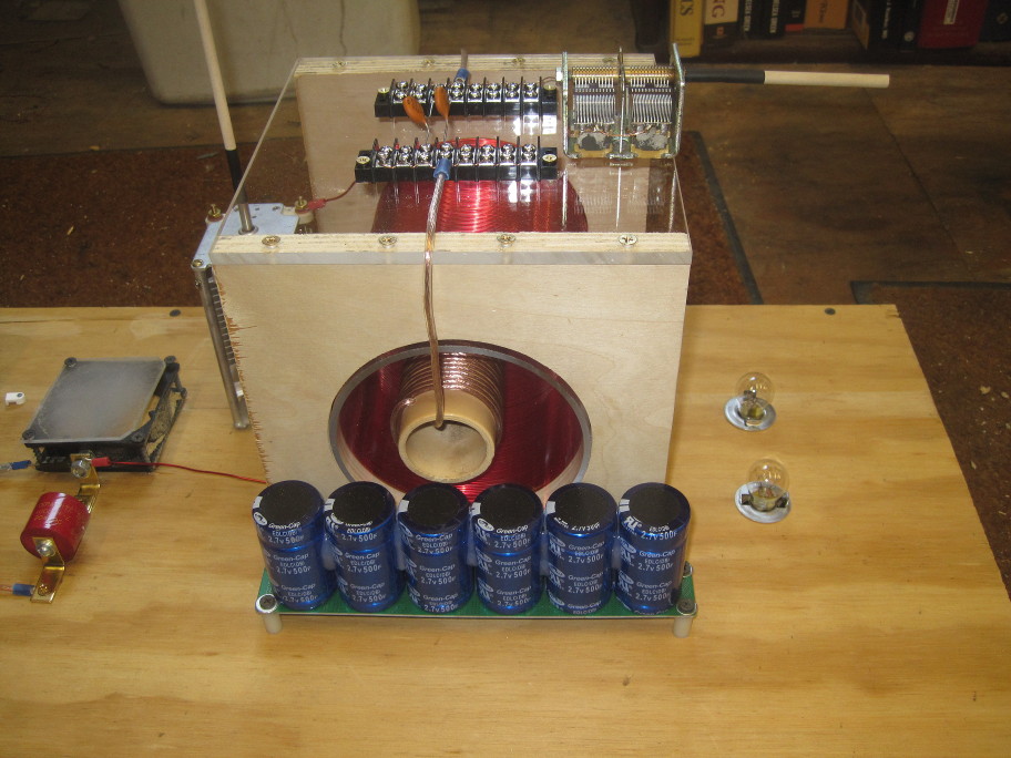

    • A little more progress today, the test device is coming together and almost ready for initial testing in open-loop mode. I added 1/4" wooden dowel rods for insulators on the ends of the two tuning capacitor shafts, using heat shrink tubing to attach them. I procured a couple little 12V automotive tail light bulbs and holders to use as a test load, if it can even light up a couple watts of bulbs it will still be revolutionary. One test I haven't yet done is to load the antenna to ground with different value resistors to find out the approximate source impedance. This will let me compute the maximum available power from the antenna in normal EM terms. If more power than this is coming out the output then obviously there is some overunity happening. In open-loop mode power could be coming from the battery so it might be powering the output, really the true power gain can only be accurately measured in closed-loop mode, where the HV supply is running from the cap bank.
      • That's a great effort tswift!
        What wattage are the automotive bulbs 21watt each?
        • The bulbs are standard 1157 automotive bulbs. They have two filaments, the brighter filament is 27W and the less bright filament is 8W. Here I have the two filaments in series for maximum resistance and minimum load on the secondary, hopefully it's still not too much bulb. It will probably take a watt or two to even make them glow dimly.

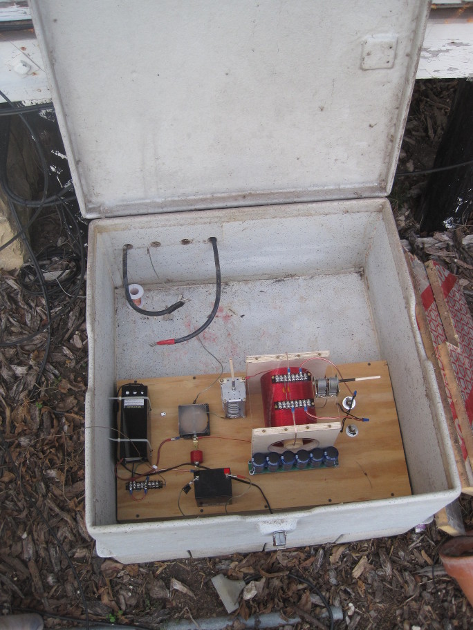

            • Initial Testing
              I installed the completed device in its test location, where the antenna terminates. So far no results to report, but I didn't expect instant success. For some reason I'm not getting a spark at all even though the HV is definitely on and working, so I'm double-checking my connections and rechecking the tuning. The picture is of the device installed in my old battery box, where I used to have 8 large deep-cycle batteries for my small solar system, before the batteries went bad.

                      • Mwtj is the first to light up a bulb in open loop.
                        Is the circuit exactly as the diagram?
                        What component values did you end up using?
                        I notice you switched to HV wire for L1.
                        Are you using a loop antenna?
                        • Originally posted by tswift View Post
                          Dragon, good to see you here! I read many of your posts from the earlier pages of this thread, a lot of the action happened before I showed up but I have read it all through, twice. I know you were around in the Zilano days, how far did you get with your own experimentation?
                          For me and the other replicators, we are just going by the instructions we have so far. The design looks promising enough that I'm committing my own funds and time hoping it pans out. I don't want to depart from the design as given yet, but if I am unable to produce results after a long time experimenting then I may have no choice. Early results from some of the other replicators look promising so I am still optimistic that this design works as advertised.
                          From past experience Dragon is a VERY skilled replicator, R&D and all out good fellow!
                          • Originally posted by soundiceuk View Post
                            Using flyback with build in diode. used positive for antenna. negative to ground.
                            Used the loop antenna and copper ground rod. No antenna no spark.
                            C1 2 x 60kv 500pf (550 measured) in parallel 1.1nf
                            C2 110pf with 2x 60kv 500pf in series about between 400 and 500PF
                            C3 10nf
                            190uH L1 38 turns. Resonant around 500khz
                            10.5uH L2 4 turns Magnet 2mm wire. Resonant around 500khz
                            Needs work to be 100% efficient
