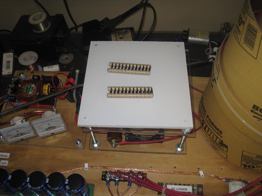

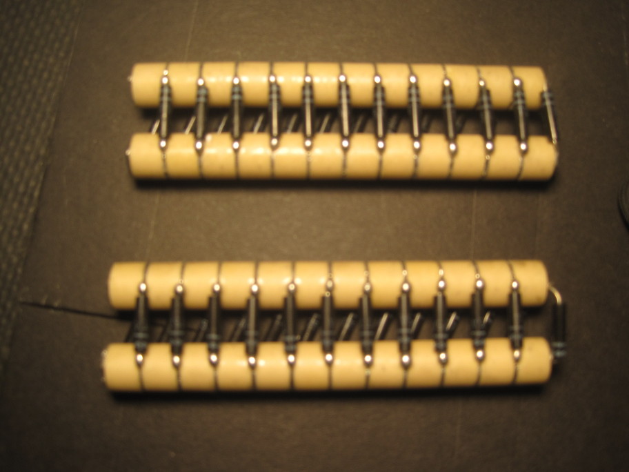

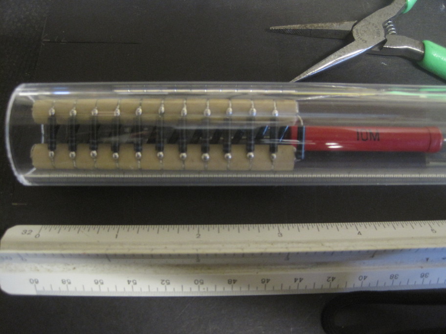

Back to experimenting. My multiplier stacks are in, I bought two of the pre-made 12 stage stacks from amazing1.com. It's unlikely I can design and build anything as compact and good looking, and if you price out the components the cost isn't bad either. I want to use two, one positive and one negative polarity. Using either the PVM12 or the ZVS to drive it (with a suitable AC flyback transformer), the driver can sit at near neutral potential while the tips of the two stacks are at high potential (one positive and one negative). The multipliers are only offered in a positive polarity, but after looking at it a while I realized it should be possible to flip one around and desolder one diode from the end, resolder it onto the opposite end, and have the correct arrangement for negative polarity. This took only a few minutes to do, you can compare the two to see the results.
To get anywhere close to the full potential capability of the multiplier (30KV per stage) it will be necessary to encapsulate it in something insulating. Oil and paraffin wax are the two usual choices, but since I like everything to look good I wanted to pot it in acrylic. I bought an acrylic tube with an inside diameter (1") almost exactly matching the width of the stack, and I have some casting resin on the way. My plan is to vacuum encapsulate each of the two into a single unit with an integral protection resistor. Unfortunately, if a diode or cap goes bad there won't be any way to fix it, hopefully that won't happen. I haven't attempted this before so we will see what kind of results I can get. I will have to fabricate some end caps out of acrylic sheet and make sure the bottom is sealed liquid-tight before pouring the resin.
When it's done, even a modest 10KVAC drive voltage from the HVM should be able to get all the voltage my coil and other wires can handle.

Those are just beautiful !!! Do they really need to be potted? Or, is this just a precaution...Originally posted by tswift View PostBack to experimenting. My multiplier stacks are in, I bought two of the pre-made 12 stage stacks from amazing1.com. It's unlikely I can design and build anything as compact and good looking, and if you price out the components the cost isn't bad either. I want to use two, one positive and one negative polarity. Using either the PVM12 or the ZVS to drive it (with a suitable AC flyback transformer), the driver can sit at near neutral potential while the tips of the two stacks are at high potential (one positive and one negative). The multipliers are only offered in a positive polarity, but after looking at it a while I realized it should be possible to flip one around and desolder one diode from the end, resolder it onto the opposite end, and have the correct arrangement for negative polarity. This took only a few minutes to do, you can compare the two to see the results.
They come with a spec sheet noting that they should be potted for anything close to full voltage output, which is theoretically 360KV (less in practice of course). Air breakdown will occur with a unit this short. I'm sure you could drive them at a much more moderate voltage and get away with it open-air, but I just want to go ahead and encapsulate them and not take the risk. Plus I want it to look cool. Like I said, it doesn't HAVE to look like a prop from a sci-fi movie, I just WANT it to....Originally posted by dragon View PostThose are just beautiful !!! Do they really need to be potted? Or, is this just a precaution...
I could build a multiplier myself but obviously it would end up much bigger than this. With these small units I can put another daughterboard right above the HVM board to mount these two, so the hot ends feed directly to the board with the PPV's on it.

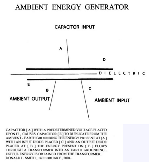

Don and I used to talk on the phone at least once a month. I miss the dude. This circuit was Don's way of showing how he drew in energy from what he called the ambient. Some call it the "zero point energy." The energy actually comes from the charged ions that are stored in the atmosphere of the planet.Originally posted by tswift View PostAhh, some very interesting circuits! In addition to the ion valves, I find extremely interesting the component marked "ion-gate" in the first schematic. It consists of a capacitor at the HV terminal of a NST and two diodes in the avramenko configuration. It reminds me very much of the Don Smith "Ambient Energy Generator" diagram:
Looking at the second figure in this document, the one called "Improved Edwin Gray Circuitry", it would seem that the antenna and ground are not, strictly speaking, essential elements for pulling energy from the "ambient" through this method. Based on my own experimentation and knowledge of the Avramenko configuration, I would propose that the capacitance of the entire circuit acts as its own "antenna" when pumping electrons with the AV plug.Originally posted by radioionics View PostDon and I used to talk on the phone at least once a month. I miss the dude. This circuit was Don's way of showing how he drew in energy from what he called the ambient. Some call it the "zero point energy." The energy actually comes from the charged ions that are stored in the atmosphere of the planet.
I also note that this configuration has a lot in common with what I was trying with my benchtop Tesla coil a couple of pages back in this thread, where I obtained white sparks on the spark gap and it seemed that the coil had increased power (not a direct measurement, just a qualitative observation).
