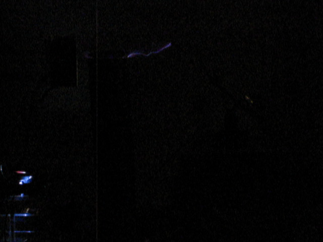

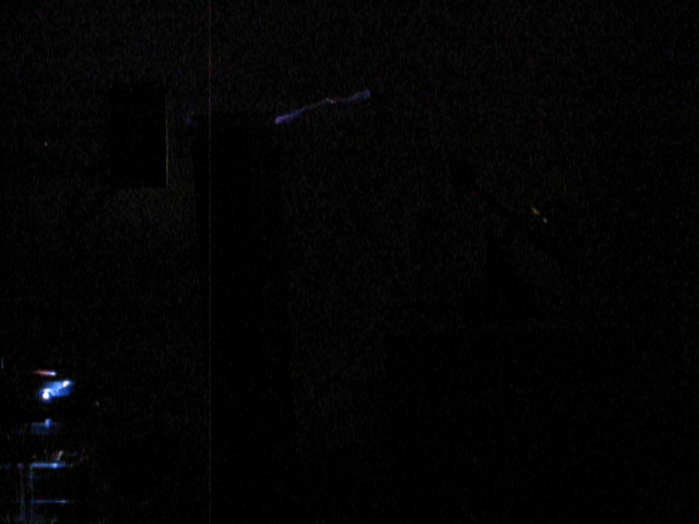

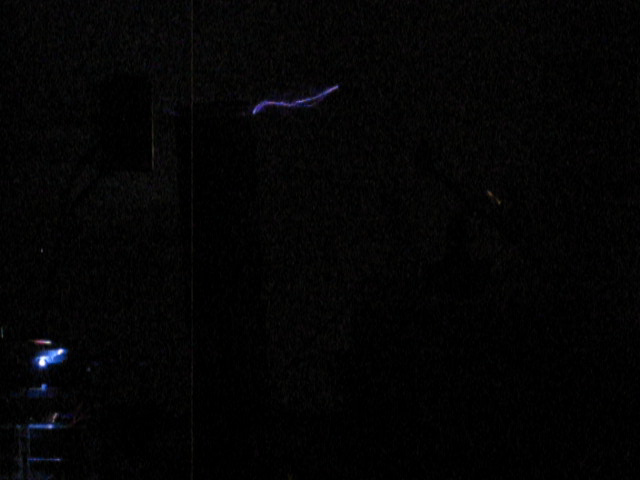

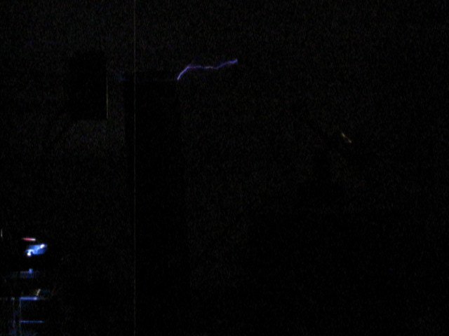

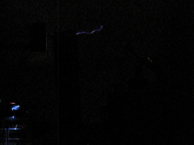

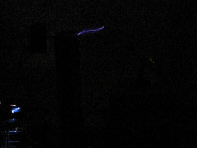

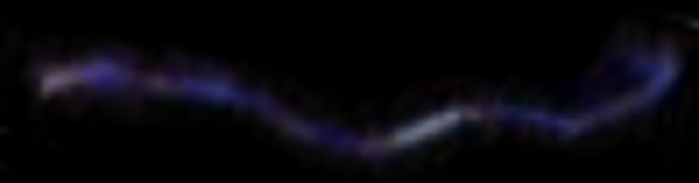

                      • To illustrate this further, I finally managed to take a picture of the white spark. It was as difficult as I expected, with lighting, exposure, and focusing all being issues to contend with. The setup is my small benchtop Tesla coil, powered by a ZVS driver. Power is about 20W. The coil is 3" diameter and about 14" long, resonant frequency about 700 KHz. None of the particulars matter, any Tesla coil should show the exact same effect. It's just that with a low power coil like this it's easy to get closer to it for observation while running, which is how I noticed the white spark effect in the first place.
                        While the coil is operating, any conductive object brought near the coil will show a fan of sparks leading back towards the coil (the "reaction"). Likewise, there is a fan of sparks coming off the coil (the "action"). When the object is brought near enough, then the two sets of streamers will start to meet on the stronger discharges, and you will find that the small region of overlap right in the middle is where the sparks turn visibly white.
                        Here is a still picture of the coil in operation with a grounded wire near the hot end of the coil. I tried to capture the white spark effect with still photos but was unsuccessful due to the exposure time. This at least shows the setup.
                        Here is a still frame from the video I took, it's much darker but the short exposure time allowed me to find a few frames which show the white region clearly. This is unretouched and it really does look like this to the naked eye while observing.
                        • Let's take a closer look at the spark itself. We can see the white region approximately in the middle, but it's not centered. This makes sense when you realize that due to ground impedance, the tip of the wire is not at zero volts. In fact it's quite far from zero, as you can see from the glow around the alligator clip holding the insulated wire in the first still photo above. Some of the voltage drop, the dipole, is happening IN THE GROUNDED WIRE. WE WON'T GET RESULTS FROM A DON SMITH CONFIGURATION LIKE THIS. We have to get down much closer to true earth potential in order to be capturing pure cold electricity at the reaction end of the dipole. How close, I don't know yet.
                          Ok, now let's put all this together. Here are the theory and experiment side by side, so hopefully everyone can understand what I am attempting to explain:
                          • White spark and more?
                            Hello Tswift,
                            Once again, thank you for your comprehensive reply. I think I have been oscillating the L2 at around 10Kv. I have made a pick up for the scope using a 100mh coil and r/c network. This clearly shows my HV activity. However, I am reading the same reaction on both sides of the isolating HV diodes - rated at 100ns. This is disconcerting as I am unable to rationalise this. I get the impression I am nullifying the output - no rectification of signal into the caps. I do not have the L2 to what I suspect should be the tuned resonant frequency. I'll know better when my HV caps arrive. I have calculated the L1 and L2 caps as almost the same as Don's! L1= .2uf and L2 = .046uf . The frequency the new coils are optimising at is 221Khz with the output from the function generator. More on that later when my components arrive.
                            I have found your observations on the white light intriguing. Very astute observations. I have taken the liberty of expanding the image to a much larger size. To my mind, I am seeing a "whorl" appearing that has more than one white spot - more like a gradual change of temperature about the emmission. And, I might also suggest that this whorl is being created within the confines of the field Hot to cold you have created. That is, the phenomenon might be indicative of a median field demarcation- a sort of "free" or "buffer" zone between the poles.
                            I hope that is not too elaborate an explanation!

                            • Originally posted by Dwane View Post
                              Yes, until you get the resonance between L1 and L2 tuned properly you won't really know. I was going to mention using a function generator to check the resonant frequency on the coils but you already figured that out. The tuning doesn't have to be as precise as you might think - the resonance on L1 is quite sharp, but L2 is loaded so its Q is very low and the tuning is broad because of it. If it's within perhaps 10% it will probably work OK.
                              Well, I am trying to follow in the footsteps of Tesla as an experimentalist. As in, do the experiment first without any preconceived theories or notions, and only after letting nature show you what really happens, then you try to formulate some theories to interpret it. Tesla was an extraordinarily careful and patient observer, and then he took great care to think "clearly" instead of just "deeply" about his observations.
                              As far as I know, the white spark observation is original to me. I didn't read about it anywhere, and I have never seen pictures of it. Most Tesla coil hobbyists seem only to be concerned with turning Mr. Tesla's most important invention (the magnifying transmitter) into a science toy and wasting more power producing ever bigger sparks. I noticed it a couple years ago, essentially by accident because I was running that coil with my head only about a foot away from it, something you can't do with a much bigger coil throwing large sparks. Anyone can build a coil like that for almost no money, the secondary is a 3" cardboard mailing tube wound with scavenged wire from a microwave oven transformer secondary. The primary is 3.75 turns around a 5" cardboard oatmeal can. The primary capacitance is 10 nF, I had to buy those but they're cheap (9 needed for an MMC). Then another $20 for a ZVS driver and you're in business.
                              What the white spark region clearly shows, by logical thinking, is that there are at least two different kinds, or characters, of electricity. If the electricity were the same all along the length of the spark they would flow into each other smoothly with no change. There has to be some kind of difference. Then we have to start speculating and theorizing what that might be, and I have offered a proposed theory that's hopefully more than just speculation, but there's no guarantee that anything about my interpretation is correct, more evidence is needed. The only thing we can say unequivocally is that when we do this experiment, the middle part of the spark turns white for reasons we don't fully understand. But that's always when progress gets made in science, when new things turn up that we didn't know to expect. For something as purportedly well as understood as ELECTRICITY in the 21st century, for gosh sakes, how is it that a home experimenter with virtually no money and simple apparatus built mostly out of scrap can produce visible results that aren't predicted in any textbook?
                                You probably shouldn't read too much into the image. It's a very poor quality picture, with low resolution and a lot of noise, taken by a very cheap camera in video mode. For comparison, here are the other frames I saved from the video which also show some of the white spark effect. Work whatever image processing magic you desire and then maybe we'll come to some new conclusions.
                                Or even better, build yourself a small tabletop Tesla coil and experiment with it yourself so you can see it first hand.
