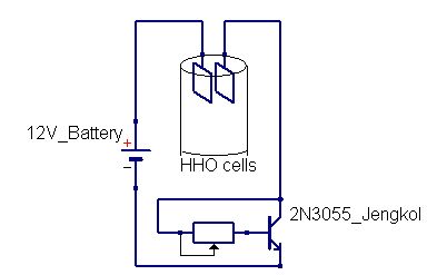

This is a current limiter suitable for small current application (up to 3A?). My main point for showing this here are to argue that you can not expect 3055 switch at microseconds range if what triggered it have miliseconds range. I think this applies to other transistor too. Although I do think that transistor improve the milisecond input to several degree faster.
3055 is not a digital switch. it will pass current depend on input.
