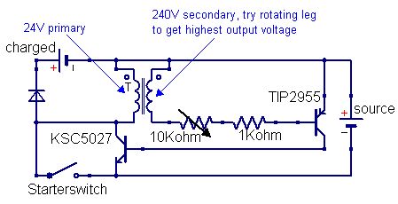

This is my attempt to combine idea of:
- radiant triggered transistor
- work on any voltage
The video:
YouTube - Joule thief triggered with radiant secondary
The result:
- input current will reduce on load.
- potentiometer can be used to tune the circuit
- the circuit do not work with switching power supply as source, a very big drawback for me.
Edit: It's working now, don't know what cause previous problem.
- more efficient than my pnp npn 555 circuit. Previous has 0.7A at 10.5V input with 0.4A at 2.7V output, this can be tuned to 0.12A at 9V input with 0.12A at 2.7V output (input voltage is an estimation).
- need bypass switch to start
- inversing secondary leg may increase or reduce output voltage. Always try with coil without common terminal (no car coil / flyback transformer), but you are free to try.
- using 15K base resistance, 12V source battery , 2.8V charged battery, output current is 100mA. Circuit will not work without load, will not work if amp meter is used to measure input current. The input current should be around 100mA based from initial experiment.
- charge two 1000mAh nicad in series in one half hour with 100mA output current. charge is real, light up 3V bulb more than an hour.
