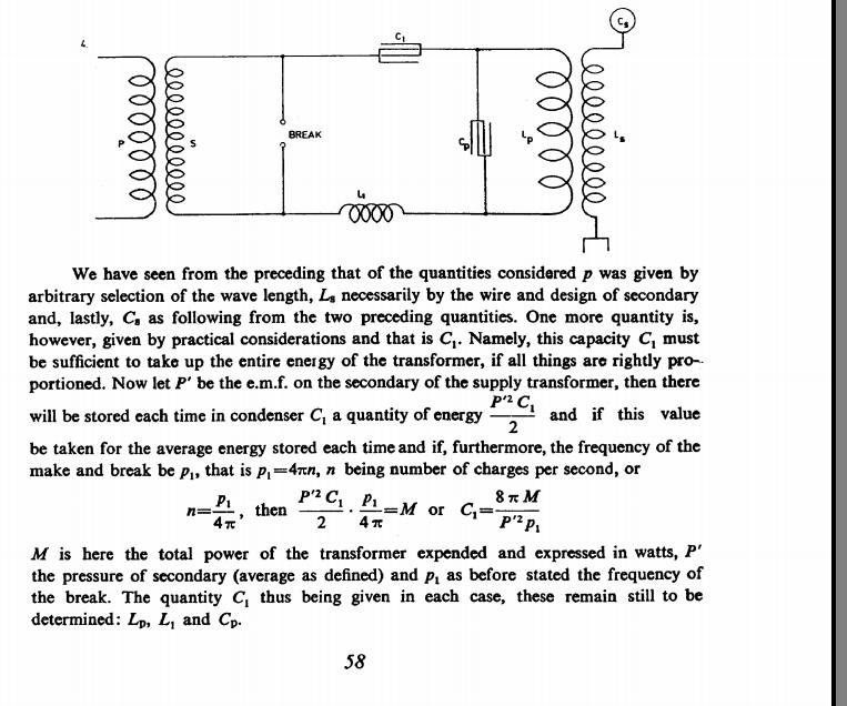

      • Its Tesla's Colorado Springs notes...
        Actually no parametric resonance in play here... only quite large Q and enormous amperages (as far Q permits). According Tesla's testimony, the jars comprising the Lp part broke down frequently due to heavy loading.
        I suggest you read the whole book. It a breath of fresh air...
        Down to that circuit, the L1 in my case will be 100-300 uH and C1 around 8-20 nF. The Cp will be 200-500 nF and Lp 4-5uH.
        From the setup readily is seen that when the spark-gap fires, the LpCp is seen as a short cut and does not affects much the L1C1 part much (if at all).
        By regulating the L1 here, we can match the L1C1 and LpCp to have some resonance frequencies..
        Thus we can ping the LC part with a voltage that defined by the spark-gap and have as much current as the Q of the tank LpCp permits.. Perhaps kilovolts range at tens amps is quite feasible!
        • Originally posted by baroutologos View Post

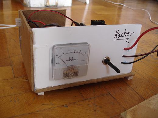

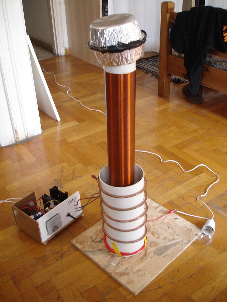

              • HF currents experiments
                I was experimenting today with my re-constructed Solid-state Tesla coil like, or "Kacher" version 2.0
                I wanted to make some measurments concerning my newly arrived HV HF diodes purchased from e-bay. Diodes tested and found "OK" working at 400-600 Khz.
                Some interesting observations were made and some Myths busted. My observations are that my Kacher lights its lamps by the use of ground via capacitative coupling, hence it required ground for the oscillation of currents.
                By using an induction coil at the bottom of it and fasten a lamp, no particular lighting I observed. from estimations, the current of my Kacher, is 0.2-0.3 amps at its base (stronger) of relative small voltage.
                Battery charging was tried via the diodes and worked, but diodes (10 KV 1amp) tend to overheat despite the fact that little curent charges the battery...
                The Myth busted was regarding the "cold electricity properties and in water lighted bulbs". I must say that even though relatively small voltage exists at bottom of my kacher, it bites... so no absolutely cold. Anyway, i conneced an halogen lamp to L1 and the other point to a ground and submerse it to water
                The bulb continue to light normally, (or slightly diminished) and was NOT shortcircuited by tap water's conductivity. My fingers were also in the water quite safely..
                This confirms and demistifies Karl Paulsness hairpin or even Ed Gray demonstartions. HF currents are not like the LF ones. It is not radiant energy. Its just currents of high frequency.
