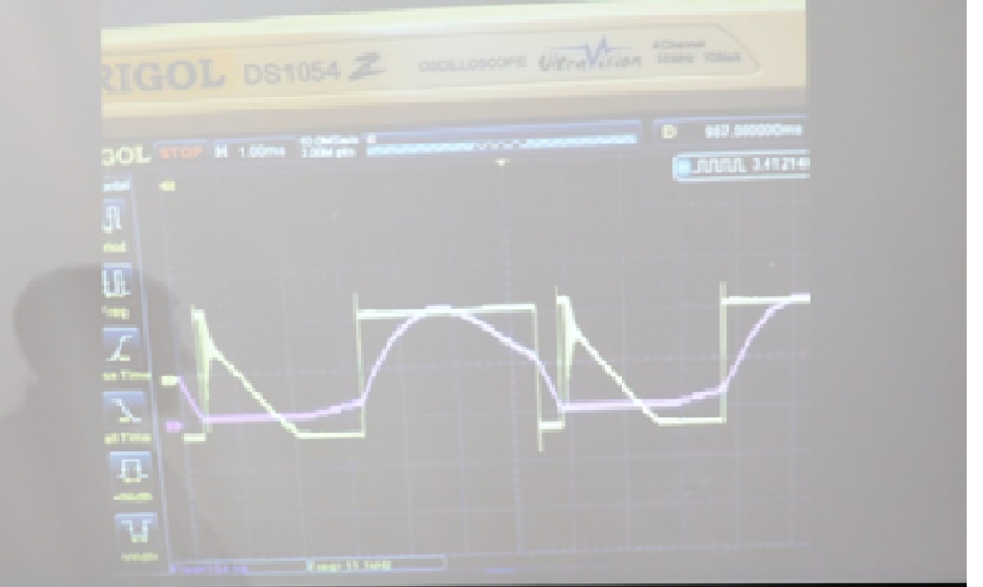

          • "what Mike showed in his video were current wave forms, not voltage."
            Mike's wave form pic.
            Is not the yellow trace an electrical wave form? The other (pinkish) is the stated current wave form.
            This is from Mile's video about his RPG.
Name:	MC SCOPE SHOT.png
            Thanks,
            bro d
            • Yes, that does look to be a voltage wave form, which I was not familiar with. I'll give it some more attention.
              The waves that I am referring to are from the 2020 video, 53 minute in. The run and capture currents are almost identical save for the spike of current on the capture wave. I am stumped as to how those are being generated. It would seem that they are still tinkering, as a later video shows quite different shapes.
              • Originally posted by serendipitor View Post
                I thought the same and came to realize he’s measuring b4 the diode and not after. The one with spike is measured after coil and you’re seeing the mag field collapse shooting a burst of current into wire. The one without spike is inlet to coil. At least that’s the way it makes sense to me.

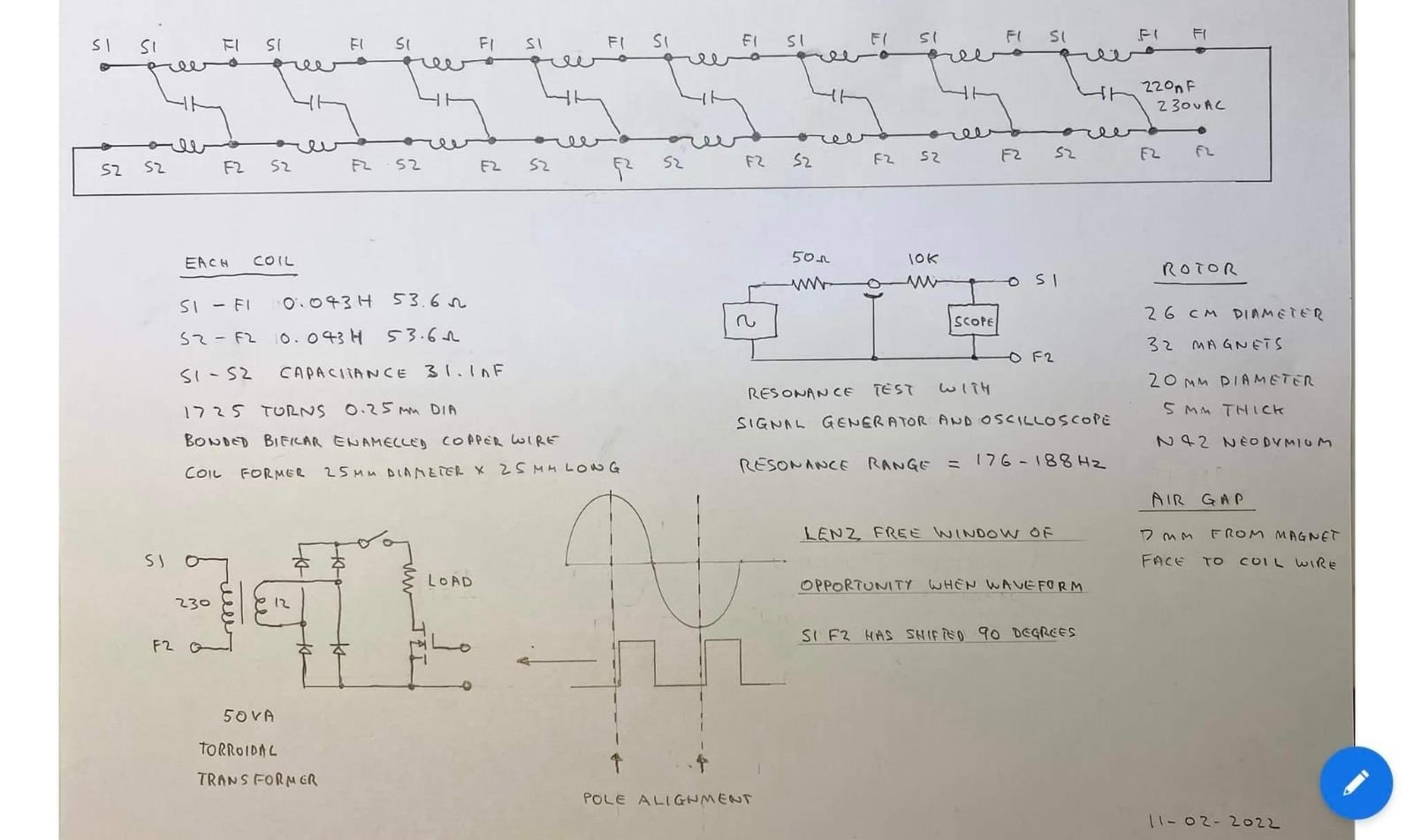

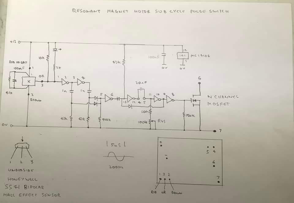

                              • Recently I found a post in a facebook group in that somebody posted some informations about how he obtained speed under load from his generator coils... Basicaly he used a little circuit to to switch his generator coil on load ,at top dead center... lenz has a push effect on rorttor.... I think ,his method can be used for improving any moto- generator design in our experiments... ... I asked him questions but I still have unclarities regarding his circuit.... Skematics was provided and if you consider to be usefull, I would be pleased to clarify with you his circuit.... My electronics knowledge are not very good so , maybe you will ask him more to clarify that... Here is the facebook link AKULA 0083-free energy | HOW TO DEFEAT LENZ LAW | Facebook Click image for larger version
