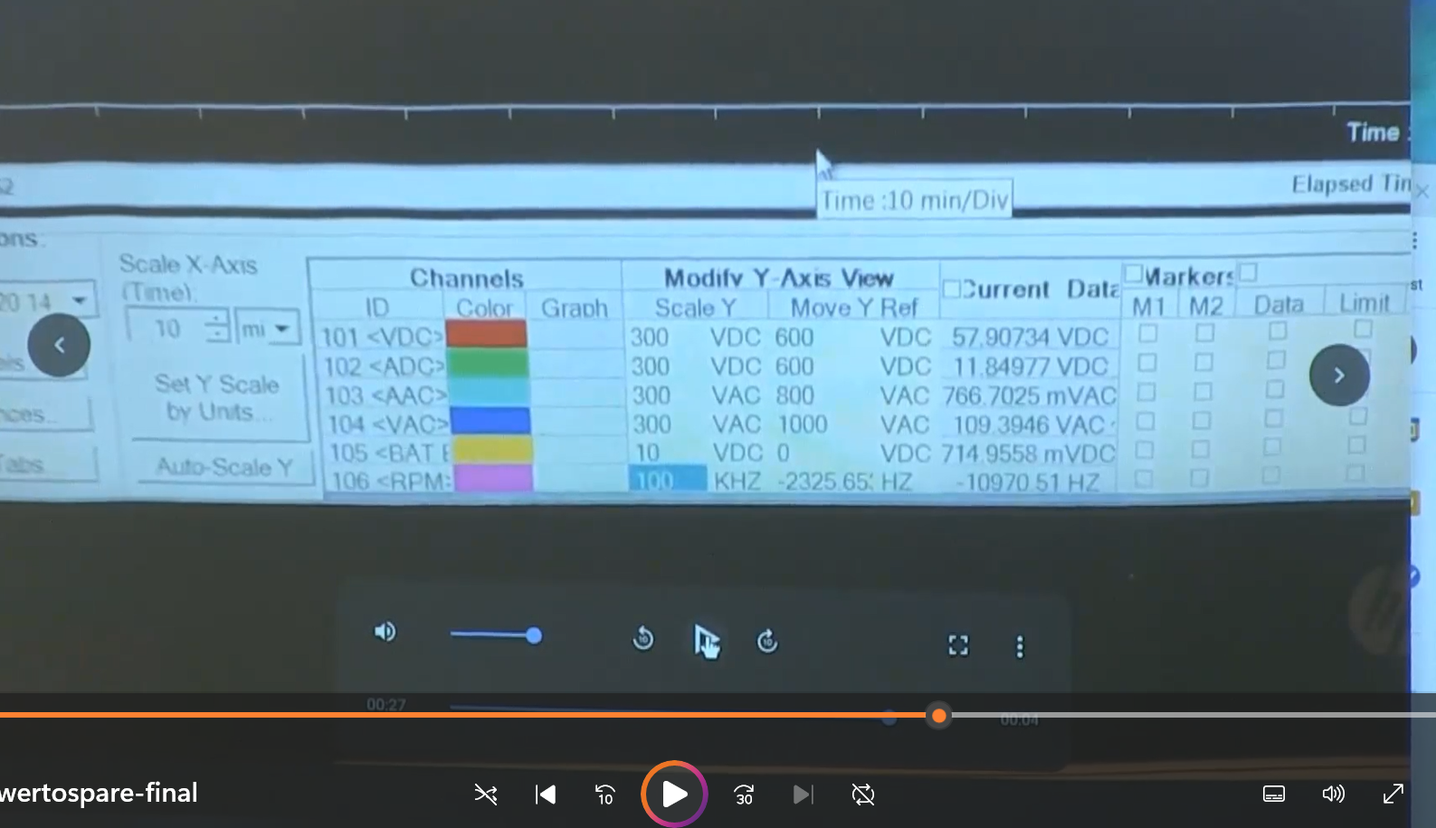

      I agree with your calcs - over a (6) hour period the machine would have used around 4200 watt-hours but if 25% of the power is being returned, then really only (0.75*4200=3150 watt hours) were pulled from the batteries. Each 12v batt should have around 1200 watt-hours (assuming they are 100Ah batts), if he has 10 of them, total capacity is 12,000 watt hours and he would have reduced that by (3150/1200)*100 = 26%
      Mike mentioned to me in a private email that he'd pulled 680 Ah from his battery banks to date. That was a year ago and maybe the number is much higher now. But if the bank holds 1000 Ah (10 x 100Ah batts) and 680 was used (minus the 25% returned in flyback = 510Ah used), then having the batts running voltage around 11.59v would be about right. They are about 1/2 discharged. If taken off load they'd likely jump up well over 12 and maybe to 12.3 or thereabouts. When pulsed batteries are left to rest they often bounce up to abnormally high voltages but when put back under load the voltage quickly drops off. (that's my experience at least)
      One other note on the trace - the Y-axis scale is set to 300v DC so a small change of let's say 1 volt in bank voltage wouldn't show up. It would be better to set the scale around 10 volts to see if there is a change over the 4-hour run depicted in the graph. I could be wrong but that's what I noticed because when I run my own machine it goes up and down a volt or so when the battery switches and this one is dead straight for 4 hours which threw me off. (see attach clip)
      It would be good to know if Mike has achieved over say 1,000 Ah into the machine and the batts are still running it. That would be the full battery capacity and would need to be adjusted for what was sent back via recovery.

          Thanks for sharing your thoughts…you are right, I forgot about two banks.
          If Mike started the 6 hour test at 60 volts and it dropped to 58 volts after 6 hours, that is impossible by conventional means. Note: 60 volts to start is an assumption at this point.
          The flyback from fast switching is not 300-400 volts, it is 2400 volts. I would think this would have an enhanced effect on the batteries.
          In my honest opinion, I believe there is enough evidence to suggest it is legit, if the batteries were resting at 60 volts prior to the 6 hour run…it is real.
          Paul said during the testing, chart we are looking at, the battery voltage never changed. To me the chart still shows no decline in voltage, you should still be able to detect a slight decline, in battery voltage, when looking at the trend, even at the 300 volt scale.

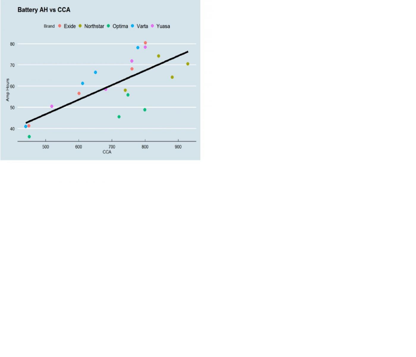

                                "where did you get the 55Ah rating for a 650cca starter battery?"
                                I googled "cca to Ah" and found some formulas and charts.
                                That is how I arrived at 55Ah rating.
                                My batteries are Everstart Plus and the website says 750 CCA.
                                My battery label says 650 CCA
                                I googled the matter again and 2 sites gave the formula cca / 7.25 = Ah.
                                The pic is from a knowledgeable site that shows inexactness to conversion process.
                                https://www.advrider.com/f/threads/r...1469713/page-2
                                There may be test equipment for this.
                                55Ah for my batts doesn't seem right now. 90 is probably much closer. Click image for larger version  Name:	cca to Ah.jpg Views:	0 Size:	44.0 KB ID:	512884
                                Sorry that I wasn't more informed.
                                bro d
