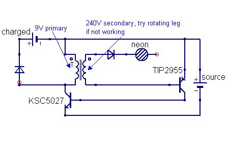

This is a slight modification of my hv triggered joule thief:
I found out that I can oscillate the NPN by triggering the PNP with HV spike only. Brighter neon can be made by conducting the free leg to ground or large conducting material. Frequency will reduce with grounding, to the point it stop oscillating.
The circuit is made oscillating by reconnecting the negative from source. Once it osccilate the coil will sing. If the driving circuit is touch by hand, it will stop oscillating. A bit similar to Aromaz circuit, 3055 driven by 2n2222, unless this do not has as much power. I smell ozone though.
