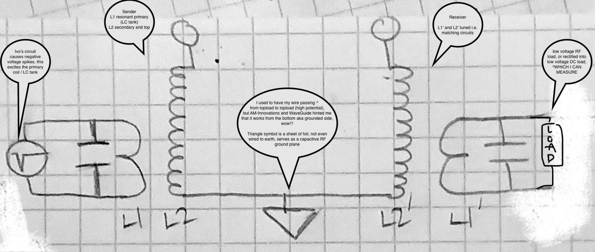

          ANYWAY thats very very specific, but wanna see my little circuit diagram? The circle part on far left with a "negative" spike in it, is the driver circuit making very short negative voltage impulses, and those connect to the tesla coil primary coil capacitor circuit. and on the other receiver side down the line, instead of a driver circuit, it powers a simple low voltage lightbulb or something basic, which can FINALLY be measured for power, definitively. Next step, look at power supply input watts, detect output watts, divide latter by former to get 'transmission efficiency'.

          even though I cannot yet do better than 50%, it's now a metric I can watch while trying different stuff and seeing how exactly it gets improved. fun, if you can believe it
