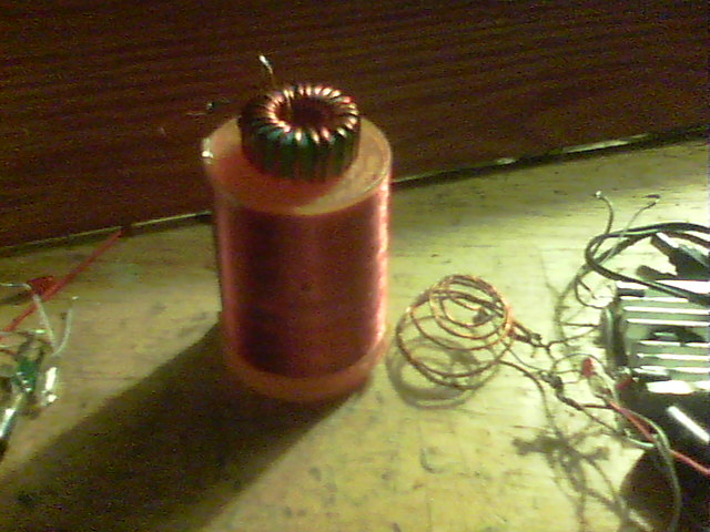

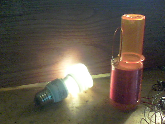

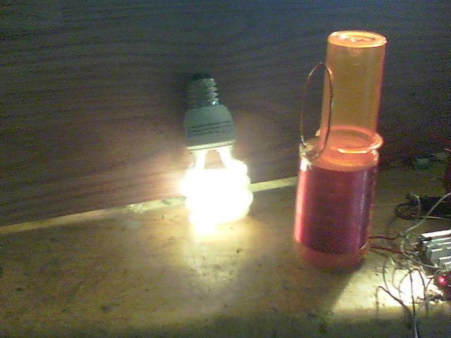

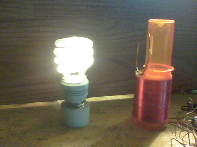

Showing a lot of promise, here we have an extension to the Walgreen type of tower, this project being codenamed 'White Crow'. The idea, was to see if a much wider tower wound with exactly the same wire gauge, would give as much power (and fun) as a standard Walgreen pill bottle.
The resultant tower, is based on the 2x larger pill bottle of similar type. Easy enough to replicate I hope, beside taking 6 hours to wind.
It is, in fact, possibly superior to the Walgreen
Built over the weekend of the Royal wedding, this is the Windsor Tower. It also looks a bit like one of the entrance towers to Windsor Castle in England.
The first windings became partially unraveled after a solder joint snapped...so it was rewound last night and the video taken today.
8 full sections from the stators of RF-310T cassette type motors make the Secondary coil.
2 turns of bell wire (22 gauge approx) form the internally housed Primary coil.
Slayer exciter circuit, using an A966 transistor.
7.5V from a regular 3V-12V wall adapter
It will run well, right down to a button cell 1.5V battery.
