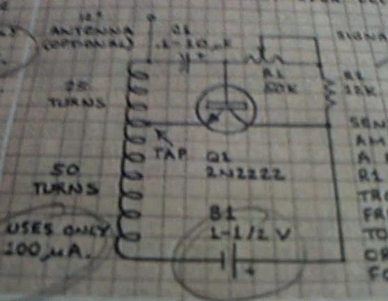

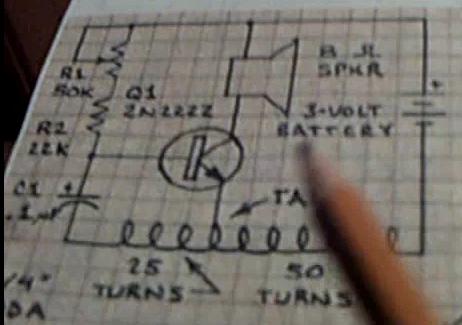

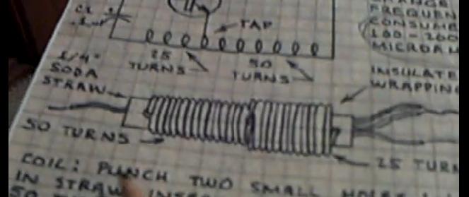

                        • Originally posted by Slider2732 View Post
                          Thanks!
                          Took a few screenshots of the schematic and the coil. Note that the feedback coil is wound in the opposit direction on top of the activation coil in this case.
                          Also note that with this coil, the feedback coil is 25 turns and the activated coil is 50 turns. So, apparantly you need a half wave between the central tap and the emitter of the transistor and a quarter wave between the centrap tap and the feedback to the base. So, that would mean for my coil: 12 turns for the feedback and 24 for the one to be activated by the transistor. If that is correct, then it appears you can treat the steering of the transistor to be by voltage and very low current, so you need to tap it one quarter wave further because of the 90 degree difference between current and voltage.
                          Looks like the best thing to do is to add an (or 2) extra tap(s) to the full-wave section of my coil, so I can easily change and just see what works best in practice. If the theory is confusing, then practice should be leading....
                          Update: Found another version of this same schematic:
                          Identifying Wildlife Tags
                          It says that this one does not produce continous oscillation:
                          The combined inductance of L1-L2 is resonated by C2 to set the oscillator's RF output frequency. The RF would be continuous if feedback conditions were stable. But in this circuit, C1 charges in just a few RF cycles and saturates the transistor, then discharges more slowly. The result is short periods of oscillation, as shown in the waveforms of Figure 2.
                          The 100pF C2 determines the oscillation frequency, together with L1/L2. I saw in Lidmotor's video that he could adjust the oscillation frequency, which he appeared to be doing by adjusting the potmeter (variable resistor). While it suggests that C1 is being charged by RF, it is being charged by the DC path from the PS trough R1 at the top and trough L1 and L2 to ground...
                          Since I can't spot any significance difference between the two schematics, and Lidmotor's frequency adjustment stuff, it looks like we have to add some modifications to make it oscillate continously.

                              • Hi gang,
                                Apologies for my absence. Been quite busy with work. I have 16 employees now so it keeps me on my toes. I've still been playing with thenexciter. I don't know whether to call it slayer or stiffer or what ever lol. I posted thisnvid a week or so ago which shows the setup ‪Stiffler exciter‬‏ - YouTube
                                In that vid I'm using a 1818 transistor. I don't use any resistor or diodes and start the oscillations using an av plug. What has me perplexed ATM is that I have been playing with the circuit on page 7-9 of Patrick kellys book, which is a "cosmic energy receiver" (my term) to test if my circuit could actually receive energy I decided to use my exciter as a transmitter. I'm using a piece of aluminum as the antenna. When it is about 1' from my exciter it charges the caps up. However when I stop the oscillations on the exciter (switch it off) the voltage on the caps jumps and climbs steadily for 10 secs doubling the voltage in the caps. WTF is going on there? Apologies if I have not provided enough info with my limited knowledge.
