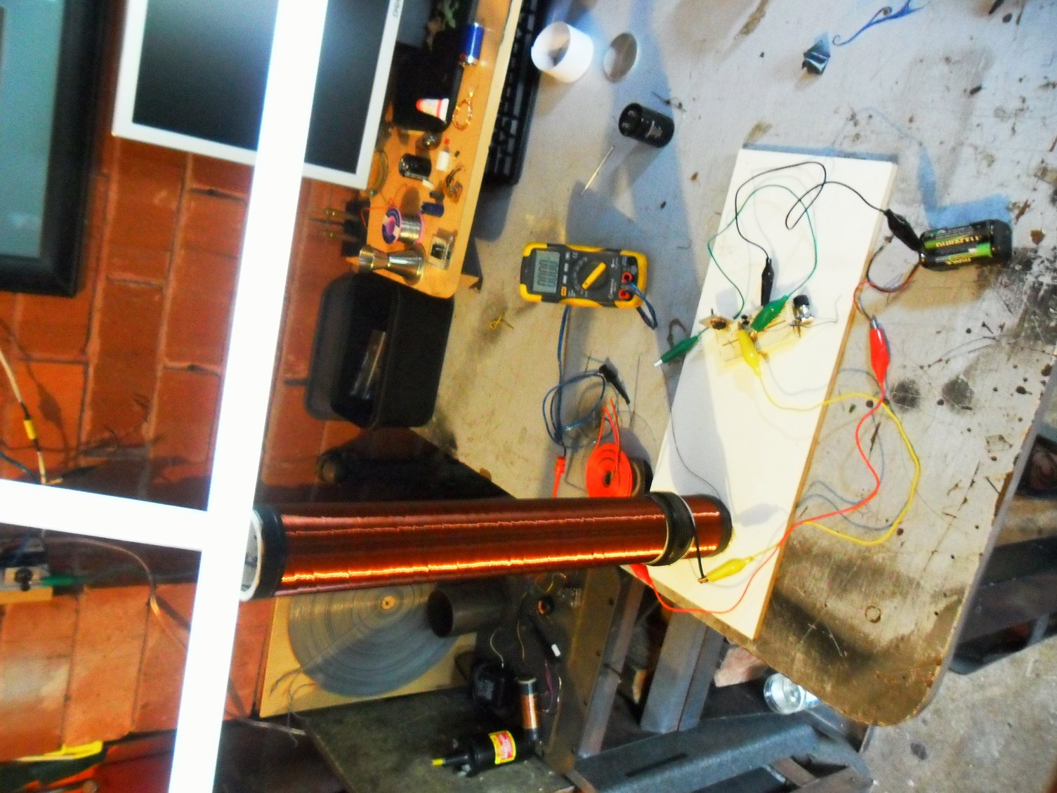

        • hi been playing got a top load on the coil now improved the brightness and distance alot and also wound me a longer coil about 1100 turns and managed to get plasma , small vid on you tube Slayer exciter / Teslacoil ? wireless power transmission - YouTube
          • That is one fine looking setup
            Decent transfer distance too for the remote fluoro.
            Btw, your topload made me think of it being mistaken for a service bell lol. Imagine some unwary soul doing just that...they wouldn't do it a second time if the tower was powered up.
            • thanks ,, yes could be concealed in a service desk that would give me a laugh , I had the larger coil running on 28 volts tonight , to my surprise the tip31 transistor stood up no pop , plasma streamers about 15mm long , and got a small 15w globe lit at about 1.5m in my hand the furthest yet ,, regards bart
              • loving these sec's run up to 30volts , now able to get some good plasma thanks to all who posted on this thread, took me a while to read it all but iv learnt alot ,, regards bart slayer / tesla coil ? fun with plasma - YouTube
