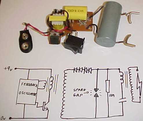

      • Hi folks, I'm sure you folks may have seen this already, however it is an interesting circuit with the cap discharging through a spark gap into the output transformers primary, seems very similar to tesla and other devices. Maybe more interesting is the fact that they were made illegal and bigclive said the legislation (so called) was rushed through over night. Maybe there is something within this device that needs more attention. Yes this is from bigclives site.
        Explore a stun gun.
        peace love light
        Tyson
        • i recently had one of those circuits to play with and yes it is interesting.
          its also not hard to follow the same idea and make one of your own using an ignition coil or something similar.
          they use a 2kV cap (or close to it) to charge up until it hits just enough voltage to bridge the gap which DC pulses the transformer.
          ive noticed that a spark gap into a transformer to make the DC pulse produces a much greater output than the DC pulse coming from a rectified transistor, or simply using the AC for that matter.
