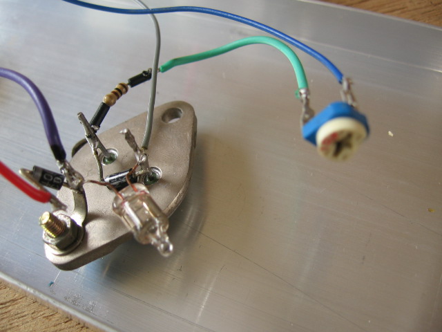

ok.. im done making 1 main coil & trigger coil with it... using 2N3055 at the moment.. SSG circuit...(havent connected the slave yet,, still no circuit)

I was also wondering if you have tried adjusting your base pot to find the sweet spot. 100 ohms sounds a little low, but it may be fine for the system you have put together. And I want to add that your build is very nice looking. Great job!! citftaJust because someone disagrees with you does NOT make them your enemy. We can disagree without attacking someone.

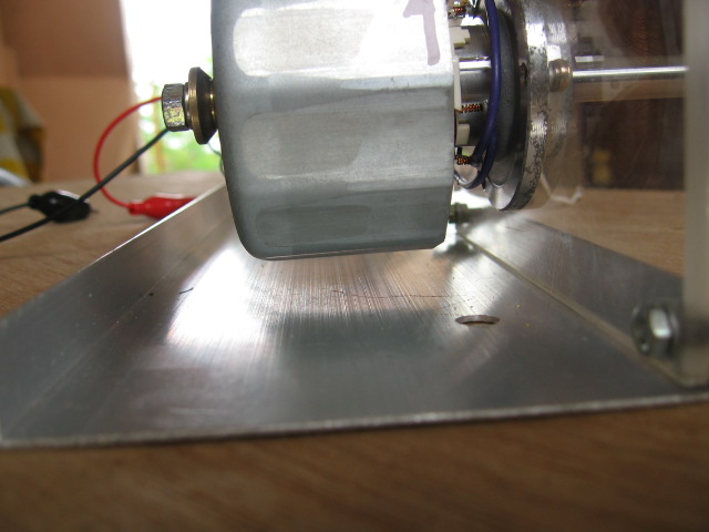

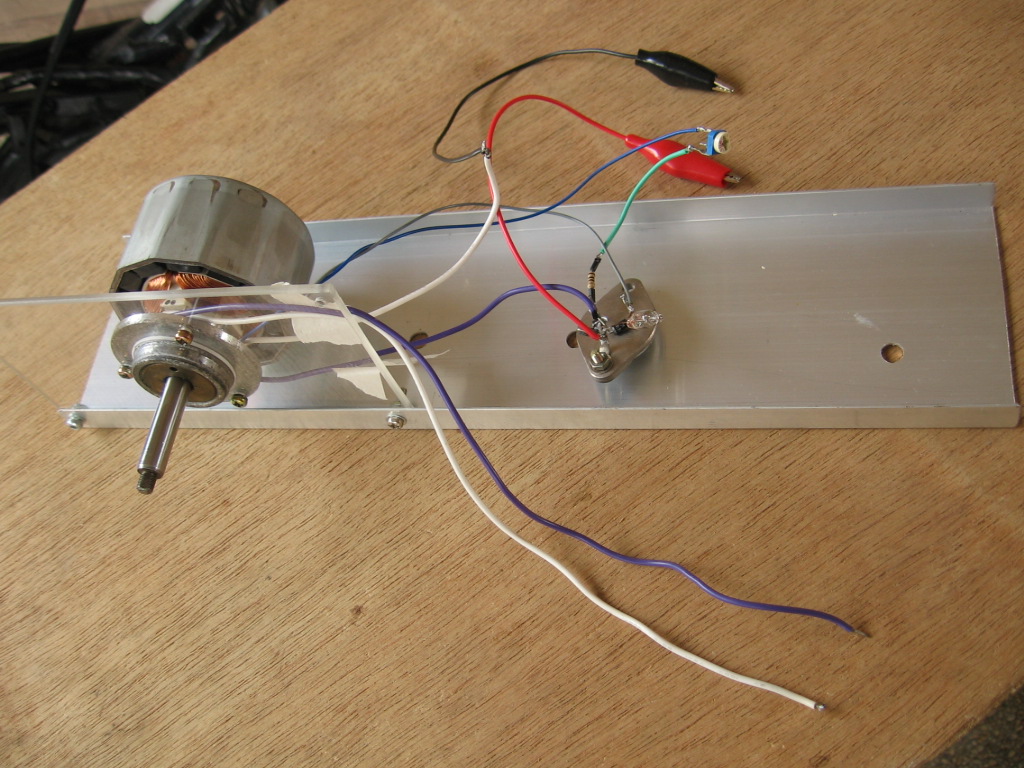

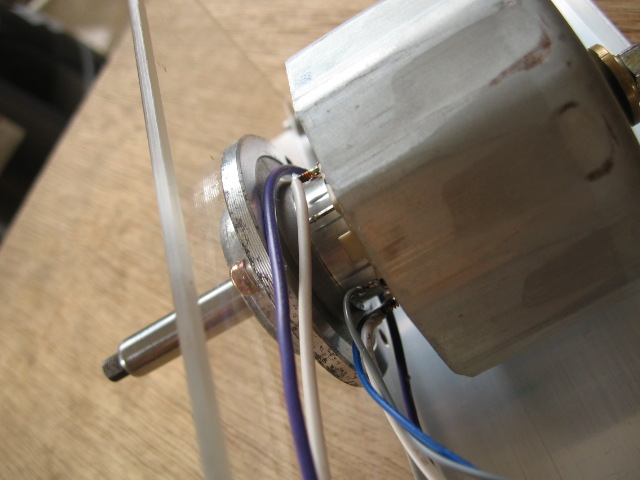

meanwhile here are some pics of my motor NOW... those 2 unconnected wires is for the OTHER set of coil(for slave) regarding the aluminum baseplate, I dont mind the "Eddy current" , rotor magnet/case is about 10mm farther from base so I dont worry too much... those wires with alligator clips are for the charging...and YES I have a trimmer (1k) in series with 100ohms... still need another DMM if I have to monitor both input and output charging current
