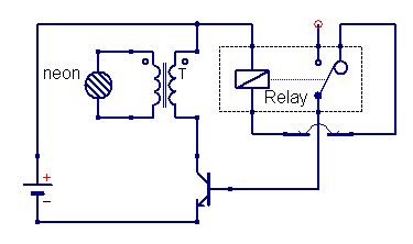

    Mechanical switch is the best switch to produce most efficient coil collpase current, but the spark create a problem. Transistor do not have spark problem but it efficiency is noticably lower because of slower switching and some voltage/current leak losses. By using mechanical switch to drive transistor we get sharp signal and no spark.
    YouTube - Relay driven transistor
    200mA at 12V, 1000mA at 22V, relay resistance is about 500ohm. If relay can not made to self oscillate, put capacitor in parallel with relay coil. I weaken the spring to make it work.

      Yes. Relay will work longer because there is no spark anymore to worry about, and since relay contact cut current more effectively transistor will work at its fastest speed. The problem is, relay have limited range of duty cycle and frequency. I think we should use other type of mechanical switch to get faster frequency or more duty cycle control.

            Something looks wrong on that diagram.
            How will you switch a relay from the base of a transistor?

              Thanks, but can you explain more? I don't get it. Are you saying we use two leaf of DPDT in series? Will that work with 1 Amp current?
              Relay is not being switched by transistor. It is the opposite.
              The circuit show the relay condition at no power. In ON condition, the current will go trough from positive of battery to relay coil, to relay contact, to relay lever, to transistor base to negative of battery. With current going trough its base, transistor will turned on. The relay coil will create magnetic field that draw the lever to move away from the contact.
              When lever leave the contact the power is shut OFF. No current going to transistor base will shutting off the transistor. No current going to relay coil will shuting off the magnetic field. Without magnetic field the lever will spring back to touch the contact again.
              When the lever touch contact the power is turned ON. the cycle continues...
              If your relay can not operate this fast, you may need to add capacitor. Relay will turned on longer by adding capacitor in parallel with relay coil. 100uF would be sufficient.
