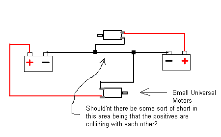

    Hi Everyone,
    I'd like to hear everyones thoughts on this subject because I've discovered that in fact it can propagate down a wire in both directions at the same time .I did'nt think that it was possible to do because it would lead to a short circuit.
    -Gary

    very nice circuit
    please measure voltage between each + and place pointed by arrow
      @gmeat,
      What you have is two circuits sharing the same ground. Superposition Theorem in Electric Circuits shows that the current running thru the wire in question is summed algebraically. If you have one amp opposing one amp, the practical current in the loop cancels to zero. Hope this helps
      Dave
        I would guess that in the circuit you have drawn it would behave in exactly the same way whether or not the bridge was there or not... two 12v batteries in series with two motors in series.

          Thx for the reply Guys,
          Boguslaw,I get a slight voltage drop of say .02 to .07 depending on which battery I measure.Dave, I'm not sure that the theorum you gave a link to is correct for the circuit that I posted and I say this because the circuit example that they show does'nt have the positives going through each other the way I do.Anyways one other observation I made is that one motor draws more amperage then the other (1 draws about 400 nilliamps the other draws 1.7 amps) so if I measure the amperage where they cross each other it will measure 1.4 amps which makes sense to me anyways.I have also tried a 12 volt lightbulb and this does in fact show that the light will lose some brightness after I connect the second battery and will start to heat up the wires so I pretty much scrapped that line of observation .Thx for the replies guys
          -Gary

                      It looks to me that your batteries and motors are all in series. What happens when you take that cross piece all together?
                        Hi Everyone,
                        Just to clarify,The batteries are Not in series.I'd like to see someone replicate the circuit and let me know what they might observe in this simple experiment .
                        @Redeagle - I dont understand what you mean by "take out that cross piece all together".Could you be a little more specific.
                        Thx for all the replies
                        -Gary

                          Hello, and no you do not have current going both ways at eny point in the circuit.
                          If you take out the cross piece you have a series circuit, sorry too late at night for me to figger voltages, but because of battery then load then battery then load then back to original battery, I'm thining the voltage never goes above eny one batteries voltage.
                          But you do have the cross piece in and that would make the circuite Parrellel so to speak , in that the voltage starts at individual batteries and fllow independent of one anouther through the loads, and then meetup and share a common wire going back to ground. I'm sure each ground turminal will introduce a slighlty different pull to the voltages coming from the loads, but that will sort itself out . The higher the negative the more of the current will be drawn to that battery turminal, and the less to the other battery turminal, there will be no crossing of currents. And there is a difference only because manufacturers can never be 100 % perfect, even if its the same battery made on the same line, back to back.

                            Try to put amp meter on one of the battery positive and see if disconnecting other battery can show measureable change of current in the battery. Maybe using lamp or other static load to get stable measurement.
                            Try to lengthen the colliding part much much longer. maybe with coil or something.
                            • #15
                              I tested the circuit using 12v 50 ma bulbs with a dc motor as the as the apparent cross point. the bulbs were not affected as i connected and disconnected the motor. i metered the voltage between the two negatives and found it to be identical to the difference in potential of the two batteries. My question is how would if it behave differently if the bulbs were replaced with a choke. potentially even a jewel thief type circuit
