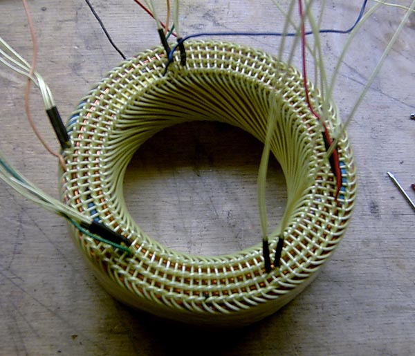

@ MK1
Just today I was going to start going through train of thought that would lead one to a build which is very similar to your own.
That is B-E-A-UTIFUL work!
Since you already know what you are doing, and others may ask, how is that an eccentric transformer...Let me explain.....
If you were to have two coils, each wrapped 90 degrees apart around a toroidal form, so that one went around the circumference, and the other wrapped around the toroid, going from center out over and over.... You have essentially have two coils occupying the same space, yet living in different worlds. One will not affect the other due to their 90 degree variation.
However you may angle the second coil, so that it is at a slant. There are two ways of doing this. One of which you showed beautifully here.
Because you have angled the secondary (or maybe primary??? could be either) <90 degrees, you have some degree of coupling.

Once again, fantastic job!
