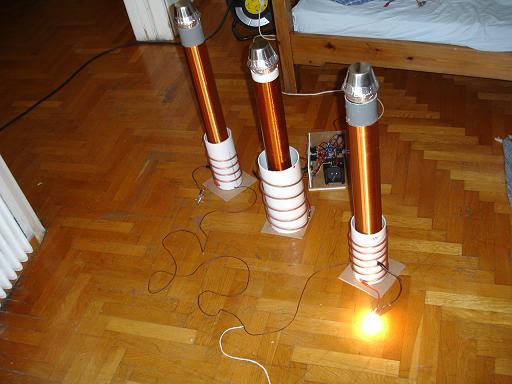

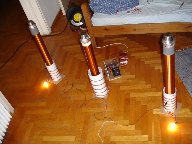

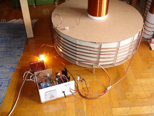

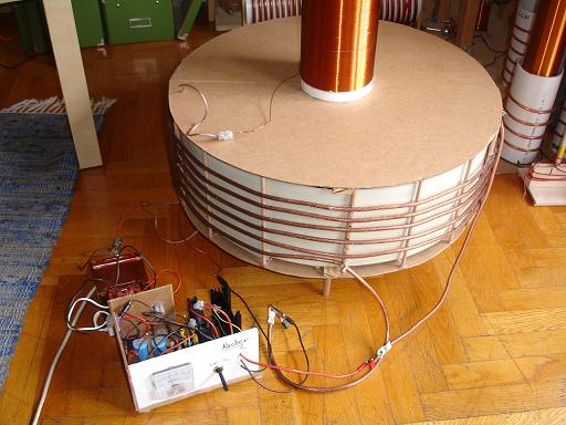

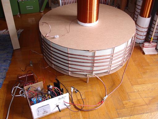

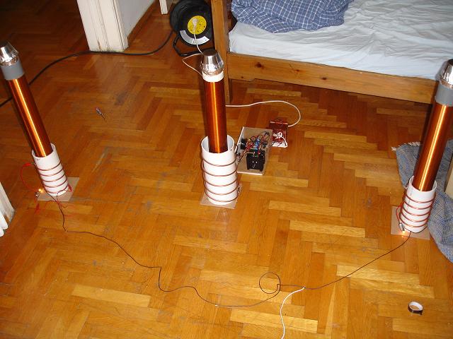

            In continuation of my experimentation with resonance concepts, i utilized my Solid State Tesla coil (Kacher) and assembled 2 similar in all aspects receivers.
            All have 75mm PVC core, 0.5mm enameled wire, same technic tightly wound, 580mm height, inductunce 10.94 mH with same LC meter and same topload.
            Minor deviations in resonance exist (as proven later) due to infitesimal differences between the coils.
            I used my Kacher to pulse the transmiter resonator at 100watt power and 30watt.
            both receivers having same low turns coil for applying the load (45watt, 12v bulb) were possitioned in various radii from transmiter and played with un-evened loads at each receiver.
            Bottom of receivers for manifesting resonance were both grounded.
            Findings:
            After experimenting several hours (my head almost fried) and in various possitions and loads i can clearly see how the main resonator's energy is distributed between them.
            If one gets loaded upon a certain degree the other gets weaker. There is a "sweet spot" in applying a combination of distancing and load, but in all cases the overall effect is 60% of power used max.
            With one receiver the efficiency is lesser.
            I cannot perceive any reason why with 10 receivers (assuming had enough space) anyone should expect OU. But the more, the higher the efficiency transfered.
            In all cases, the transmitter (unless receiver is brought quite close) remains unaffected in consumption terms.
            When goin down in transmitter power (30watts) receiver power diminished linearly as expected.
            I managed to attain a wireless power transfer of 30-40% efficiency at 1,5-2m. Better Q resonators would have better results of course.
            conclusion
            Mine conclusion is this is a fun yet lossy procedure.

              In my case with the Kacher transmitter and the two receivers, if one is loaded then max lamp brightness is attained. If both are loaded, brightness is diminished and by making correct adjustments (impedance matching) you have a more or less split of power.
              BUT, if one receiver has his secondary SHORTed, then other outputs full power as if no other load is applied.
              The same thing with my Kacher running the magnifier coil. If in few turns coil (that is wound near to secondary) a bulb is applied, resonance diminishes. if it is shorted, resonance is mainly unaffected.
              A remote resemblence i have experience in the past with mechanical setups as Thane Heins perepiteia. Ashorted coil under some circumstances poses no load, whereas if loaded then posses.
              This simple phenomenon puzzles me considerably. By considering standard transformer theory that should not happen. A shorted secondary that allows max current development on it should pose max load. Obviously not the case.
              two things come to my mind. A dead load (resistance) interferes with current phasing or just the traditional concept of mutual inductunce that leads to diminishing inductunce etc holds no true.
              Your views?
              ps: unshorted Kacher consumption 4A @26v, under load 2,8A @26v, shorted about 4A@26v
