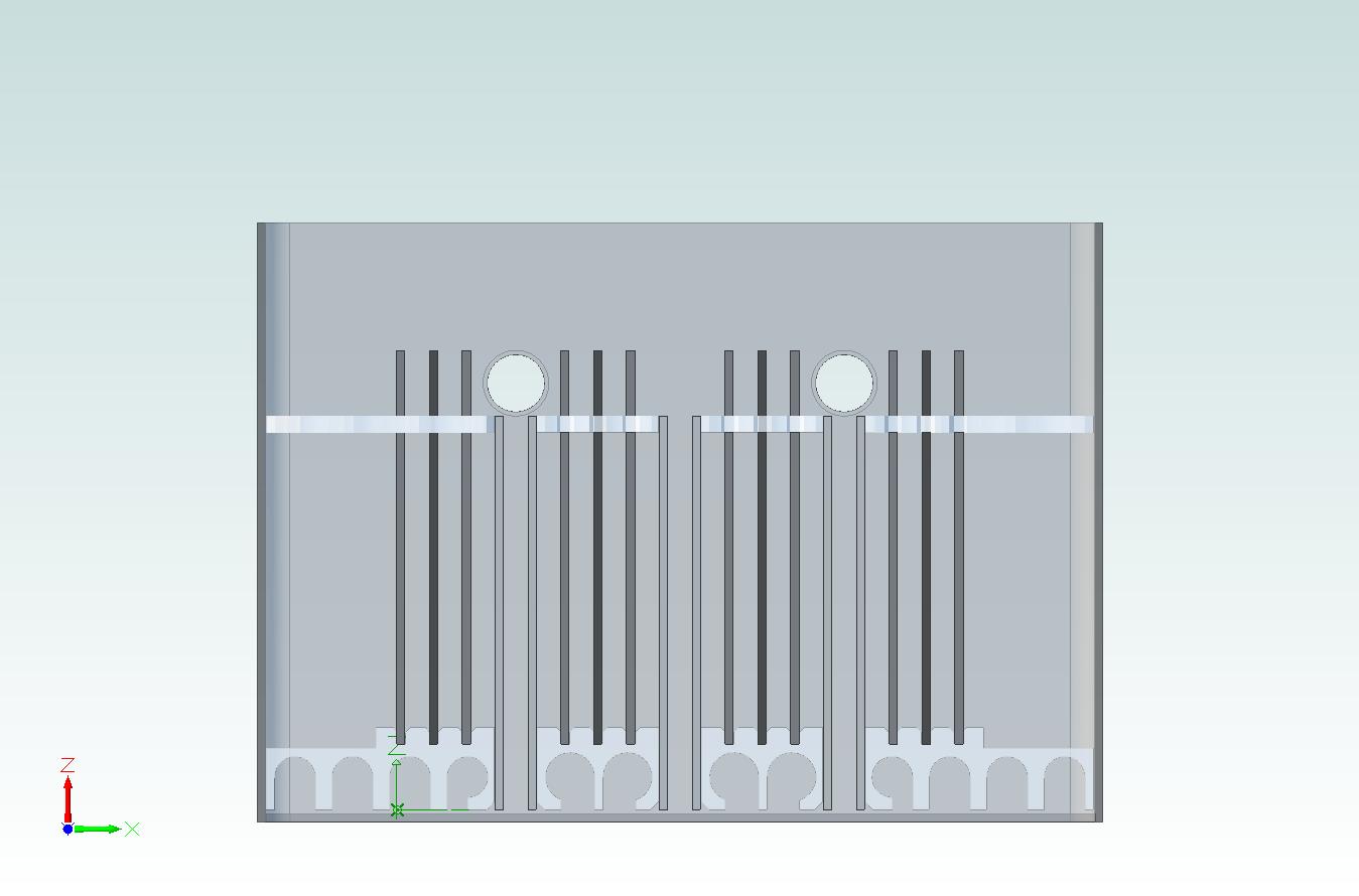

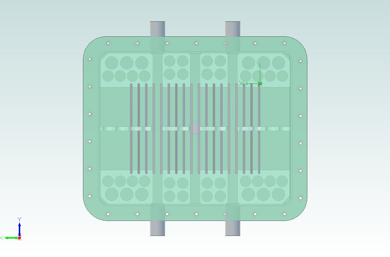

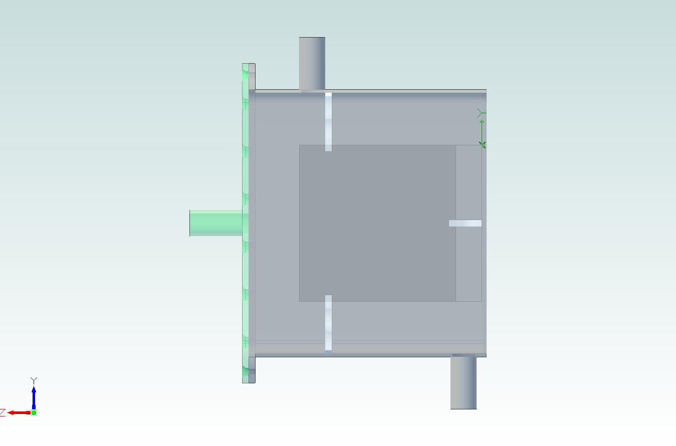

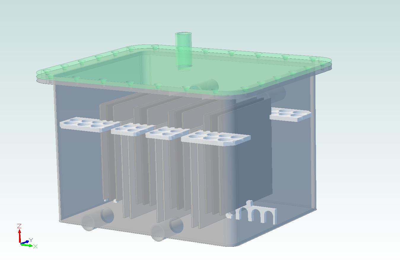

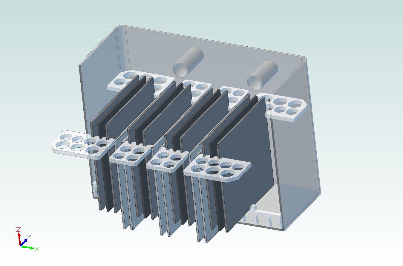

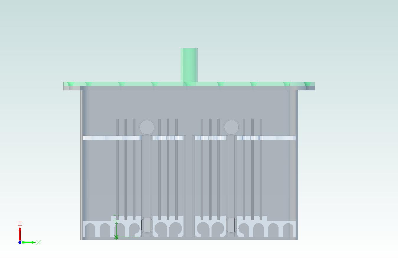

      • hi bill,remember this is also a saltwater battery,each cell is meant to develop 1.5 volts 4cells = 6volts i don't know how it would work as one cell but would be fun to find out. when you hang the plates inside the cell the rod that runs from end to end fiberglass rod mitt shrink tubing over it does ok. plate spacing of 1/4-3/8 from each plate and end of tank sides need at least 3/8 so you can put a 1/2 nylon strip with grooves cut in it to keep the plates from knocking together and off the side of the tank. 1" up off the bottom works for surculation as wel as giving room for the sep. to go around.you want a least 3" above the plates for water slopping around.
        get and old triple sink from a restraunt for cheap stainless to weld with min. warpingtake the base plate and some 1/4"x3"steel strap and clamp it down then tack it on end, middle, end that way as it warps you can keep it on line. keep going remember my motto" ya don't know till ya try". all the best, reaper. oh the best price on sheet mg is source one metal out of sterling hgts,mi

                • looks good bill. much success.reaper

                        • hi bill, if you look at the patent you will see the plastic tank at the top which has two al plates in it. that is the stone. your plate ratio is 3to1. if you have a cad program try 6" and 8" or 6x18,8x24 for plate size and scale the rest of the tank off that. at least scale your tank to the same scale. size and surface area make a big diff. don't forget the two al plates or it will go base ph on you.reaper
