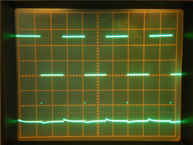

                            So far I have used a Bedini fan with the setup with an SSG setup for starters. I am not sure everything is ok, since the first voltage i hooked up to the setup was 12 V. It did not like that, I smoked at least 2 555 chips with that setup. So I have moved to 4 AA batteries and it seems to be stable with that.
                            I think the next thing I should do is give you a scope shot of the wave with nothing hooked up.
                            I watched your video again today and I see that you calibrate with the frequency setting on your volt meter. I don't have one of those meters, so I guess I will start with basics and upload a scope shot of the output.
                            Let me upload the scope shot, of just the frequency generator with nothing attached and see if what I have is right, it looks like a square wave if I remember right.

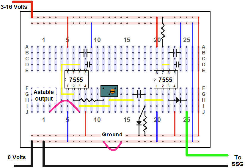

                              Hi Mart,
                              The only time I have had reported failures with this circuit is when the SSG is run without a charge battery, the induced negative voltage in the trigger winding causes pin 3 of the monostable to go below zero volts destroying that chip. You are correct, the astable should show a square wave but on the high to low transition the mono stable outputs a 5 microsecond pulse directly to the base of the transistor via a 1N4007 diode connected to pin 3 (green wire in the schematic). The scope waveform at maximum frequency should show this very short pulse if you connect your probe ground to circuit ground and your probe to the green wire. The circuit should consume very little power as the short pulse to the base of the transistor carries very little current and as a result the supply voltage shoulde't affect the circuit to any noticable degree. I have had no reports of anybody applying this circuit to the fan conversion but as long as it is an SSG circuit I shouldn't think there will be any problems.
                              Regards Lee..
