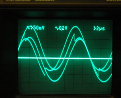

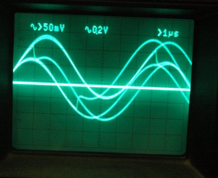

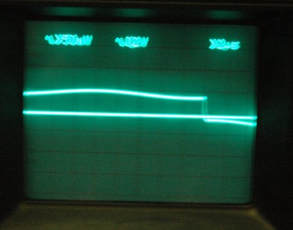

    I made a new video in hope it will help replicators to better understand how to tweak the signal generator for the Toroid coil to send back the most current. I also measured the current going to the gate using my scope probe across a carbon 100 Ohm resistor. The below scope shots are the results.
    Link to video: YouTube - Self Running Coil test 7
    Luc
    This first scope shot is when the coil is at the neutral point (no current used)
    This second shot is when it is tweaked to send most energy back. One can clearly see that less current is used when sending back the most current. This is difficult for me to understand
