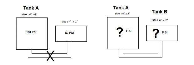

I'm looking formula to calculate "joint pressure tank" as picture shown in the attachment.
I try searching on the internet have not met the formula.
I Assumed as below:
Volume Tank A (VTA)
= 4 x 2 x 2 x 22 : 7
= 50.28 inch3
Volume Tank B (VTB)
= 4 x 1 x 1 x 22 : 7
= 12.57
Volume pressure tank A (VPA)
= 50.28 x 100 PSI
= 5,028
Volume pressure tank B (VPB)
= 12.57 x 50 PSI
= 628.6
To calculate joint pressure (not include pipe)
= (VPA+VPB) / (VTA+VTB)
= (5,028 + 628.6 ) / (50.28 + 12.57)
= 5,656.6 / 62.85
= 90 PSI
Please correct me if above calculation are wrong.
