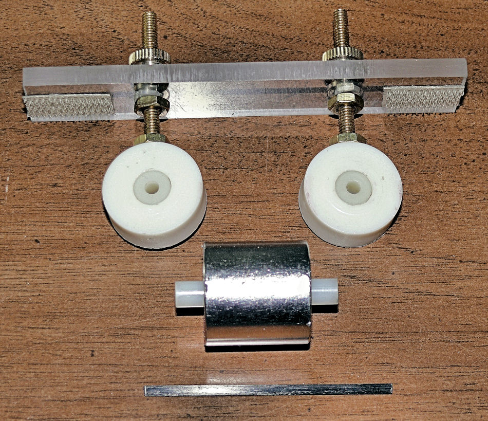

I can E mail you a jpeg Bedini/Davro circuit diagram that has all the info you are looking for. For starters you also will need to buy a 1 inch long, 1 inch diameter Diametric ring magnet that is polarized on the rounded sides. Not the ends.Originally posted by dllabarre View PostDo you have a place where I can see the schematic, each coils construction specifications like size of wire and turns, magnet specifications?
I'd like to duplicate what you have.
Magnet has a .25 inch diameter hole through the center of it.
Send E mail to [email protected] and request circuit info.
Also need to construct a non metalic spool that your magnet will fit inside and spin. I used #30 AWG magnet wire and 3200 feet of it wound around a plastic spool. Single strand.

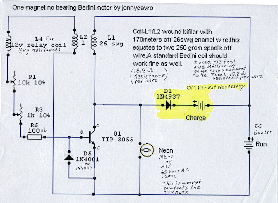

Here is the Bedini/Davro circuit minus the magnet flux pickup coil and magnet.Originally posted by dllabarre View PostDo you have a place where I can see the schematic, each coils construction specifications like size of wire and turns, magnet specifications?
Tom
Hi Tom, This is looking really interesting. Based on the numbers I've seen so far on OU and here I'm wondering at this point if there is any way to transform the out put down a bit in voltage (with an associated increase in current) to feed it back to the input and then disconnect the battery/power supply to see if it self runs. If that could be worked out then you've really got a big winner
Hi,Originally posted by ewizard View PostHi Tom, This is looking really interesting. Based on the numbers I've seen so far on OU and here I'm wondering at this point if there is any way to transform the out put down a bit in voltage (with an associated increase in current) to feed it back to the input and then disconnect the battery/power supply to see if it self runs. If that could be worked out then you've really got a big winner
After I rectify the AC to DC I will run whatever DC I need back into the input DC power source then disconnect the variable DC model train transformer I have been using for my DC 6 volt power source. Then see what happens!! I can hardly wait. My holdup now is I am waiting on a 450 volt .22 mfd capacitor to smooth out bridge rectifier ripples.
