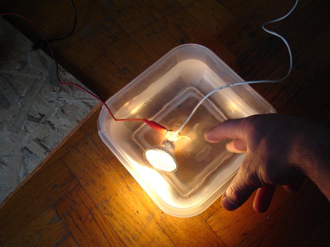

    This is a method to create a standing wave in a resonating circuit. By doing this we physically create NODES where the voltage is separated from the current component. If a lamp is connected to the hairpin in the current node it will light up. And burn underwater, a 100W halogen burner will run on hair thin wires that would normally burn up in a second. Clearly this is not normal electricity. If it is an RF effect-could it light a filament? Is this the so called radiant energy?
    So far the discussion goes into several directions:
    1. Air core for the coil? Or copper rod? Or ferrite rings?
    2. What does the ground connection do?
    3. What is the nature of the energy on the output?
    Lack of experimentation with currents of High frequency can lead to think them as magical or "radiant" since it has become a catchy word.
    Regarding Tesla's hairpin circuit, that has some striking resemblence with a Tesla coil primary we are dealing first with a typical LC oscillation (say 500Khz) and a superimposed much higher frequency oscillation that creates nodes on the "hairpin"
    The reason, halogen lamps are used instead of common incadescence is because they can tolarate much more RF+ spikes and light normaly.
    Conerning the light bulb under-water, it is a bahaviour of HF current also. YOU must bear in mind HF current s behaviour is radically different that low frequency or direct ones.
    Concerning the "hair" thin wire, if you have ever made fuses of your own, you should know that a typical hair-like copper wire can be used up to 2-10 amps fusing.
    I undestand that most newcomers in the field are attracted by the fascinating aspect of novel for them phenomena. Upon this fact, a LOT of merachants have made big business... just to know.
    Best way IMO is to experiment with what you regard as weird, make observations, seek knowledge and proceed.
    ps: The bulb in the tap water is 40w halogen lit by a Kacher run at 500Khz (more or less) and not hairpin circuit.
