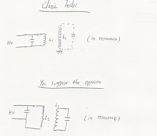

                Since I really don't know how JLN or Kapanadze is actually going about it I've been theroizing on my own of how to accomplish it and came to the conclusion it's nothing more than a reverse tesla coil. Instead of putting HV low amps into L1 and converting it to extreemly high voltage you do just the oposite... put the HV into L2 and convert it to lower voltage and higher amps through L1. The trick is getting L1 to resonate with L2 in its reverse form.
                I have been experimenting with reverse Tesla pulsing setups with no added beneficial effect noticed in any case.
                Mine setups consisted of a HV source (80-90% efficient), charging a capacitor (15,25,50 and 125 nf) which in turn via a spark gap (carbon electrodes with or without magnetic quenching) discharging in a coil of many turns (air core or wound on ferrite core) and a L1 placed over it of few turns with a load (bulb) harvesting the energy with or without a capacitor attached for resonance operation. (actually without capacitor works even better) and ground was tried it several possitions.
                In any case no running of the bulb at its nominal brightness was observed with less wattage even if the system was efficient enough. (80 eff. average)
                i know you have said in the past you can run 1500watt resisitive loads with 500watts input, but this not what i see in my RLC circuits. and hard to believe to be honest.

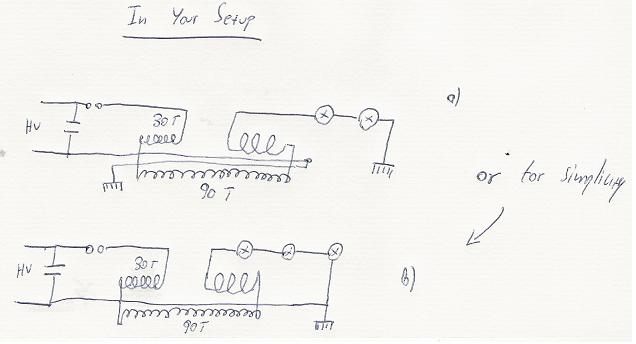

                L1 being very low inductance using the earth ground through a load creates a psudo tank in which L1 can reach high amps. I still don't have the resonance dialed in quite right with this one although it seems to drive L1 reasonably well ( L1 being the 6 turn coil - L2 being the 90 turn coil - L3 the reversed 30 turn ). L3 is used to raise or lower inductance to help match the two. It might even help to make this one adjustable to some degree.
                Since in your setup all coils are actually one coil wound in different directions, cross-sections and different wire gauge, how a resonance condition can be achieved since the same current flows everywhere in the same phase?
                In your setup, removing the ground at all, seriously diminishes the output?
