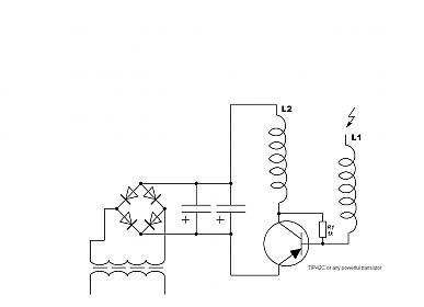

                  Much easier, working schematics
                  Resistor is 1k, transistor TIP42C, or any powerful

                    @ABC Thanks for the simple schematic!!! what are the number of turns on each inductor?
                        You're welcome.
                        Primary - 3-5 turns of heavy gauge wire, I use D~8mm
                        Secondary - the more the better
                        If it doesn't work, change polarity on the primary
                        ABC

                          Sounds simple enough!!!! Thanks ever so much for your help....i might go to the market tomorrow and get that transistor......do you know of any others which will probably work??
                          I can use the inductors i already have in my tesla coil and kapagen. lovely!

                            that circuit will work with very range of PNP that is rated to the voltage and current that you will be putting in the system...
                            you can also use an NPN transistor like TIP3055, TIP31C, but that ones are rated to 100V i think... to use the NPN circuit, just invert the colector and emiter and put: emiter to battery negative, and colector to primary and end primary to battery positive!
                            my first taught is this was a new concept, but is the same concept of what the guys call as "Wireless Exiter"... the circuit is identical, but maybe this katcher is used with much more power?

                              About 10-20W (18v, .5-1A)
                              Any power transistor will work just fine... Just don't get shocked by the scope shots
