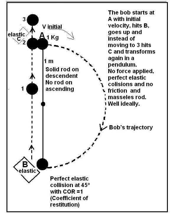

Let's compare the two for a height of 100 meters:
A straight line fall can be calculated using this:
Description of MotionPendulumLarge Amplitude Pendulum (notice this one is pendl)
So that is a little more accurate at 23.603624209842796 seconds for a full period or about 5.9 seconds to reach BDC from the starting point.
And what of it's velocity? Borrowing an equation from here we get:
So the velocity is 44.271887242357310647984509622058 m/s
same velocity, longer period.
Cheers!
v = √{2gL[1-cos(a)]}
where:- v is the velocity of the weight at the bottom of the swing
- g is the acceleration due to gravity
- L is the length of the wire
- a is the angle from the vertical
- cos(a) is the cosine of angle a
same velocity, longer period.Cheers!
