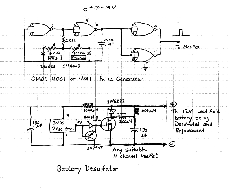

            Actually, I've had pretty good success recovering
            those badly deteriorated sealed batteries; so long
            as the cells aren't shorted.
            I carefully expose the vent caps and with a syringe
            slowly add distilled water until the fiber plate separators
            are saturated. It takes time for the water to seep
            into the cells so patience is needed.
            Then I hook them up to my pulser to desulfate them
            for a prolonged period of time while monitoring the
            voltage and temperature. They may get warm to
            the touch but I never let them get hot.
            After several weeks they will have recovered considerable
            capacity. Then a series of charge/discharge cycles with
            continued pulsing will benefit them more.
            It isn't always possible to get back full capacity, but
            70% or better is nearly always possible. But only so long
            as none of the cells have shorts.
            My pulsing circuit is a 'modified' desulfator which is
            powered by a small DC transformer wall wart.
            Attached is the diagram for the CMOS Desulfator
            Circuit which is the basis for my pulser. The desulfator
            circuit as diagrammed is a variant of the Couper circuit
            which is powered by the battery being treated.

                If so, that may be a design flaw in the charger.
                With "wet cell" batteries a certain amount of
                gassing is beneficial to the electrolyte in that
                it mixes it well, thus preventing stratification.
                Long pulses will encourage gassing while very
                short pulses will encourage desulfation with
                little gassing.
                If gassing is excessive it can be damaging to the
                battery. Very short pulses (5 microSeconds or
                less) will produce very little gassing.
                Long pulses (100 milliSeconds or more) will produce
                much gassing.
                For charging/desulfating/rejuvenating Sealed Lead
                Acid batteries very short pulses are needed.
