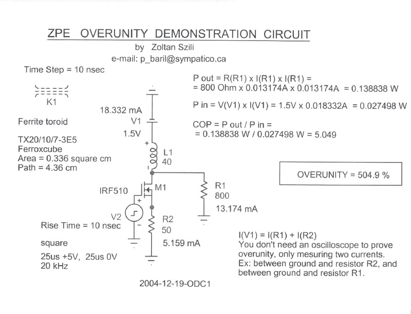

                I wonder if you find this report from Mr. Szili interesting:
                Free Energy Electronic Circuit by Zoltan Szili email:  [email protected] Introduction By publishing this very simple circuit, I would like to give the amateurs, the occasion to prove that the electric extraction of power of the vacuum exists indeed. The goal of my letter is to make known m...
                  I haven't figured out yet what is wrong with the calculations but something is not right. If you add up the current going through R1 and R2 it equals the current coming from the battery so there is obviously no OU. I think the problem may be in the fact the current through R1 is only on for 50% of the time and the current through R2 changes each time M1 switches on and off. The power calculation is for a steady state ac or dc circuit not a pulsing circuit.

                    What about the input marked V2 ? This does not figure in the calcs.
                      Input V2 is only a drive signal for the gate of the mosfet so the power there is so small it really wouldn't make enough difference to matter. Mosfets are controlled by the voltage on the gate and not current.
                        R1 has steady current R2 has pulsed current
                        current in R1 is ten times more than it should that's why the calcs are off..voltage should be 10.4V over R1 not 1.5V for the output to be like this...

                          Sorry tachyon but I have to disagree with you about R1. When M1 turns on the current through L1 will be restricted by the inductance of L1. At that time what current is available will be divided between R1 and R2 with R2 getting about 16 times the current as R1. This will be true until L1 reaches saturation of the core material. If the pulse is long enough for the core to be saturated then R1 will have current through it equal to 1.5 volts divided by the resistance of R1 which is 800 giving a current of .001875 amps. And the current through R2 will then be equal to 1.5 volts divided by the 50 ohms giving us a current of .03 amps. If the pulse is not long enough for the core of L1 to reach saturation then we can only guess at the current going through either one since we don't know the actual inductance of L1. With the inductance known we could find the instantaneous values of current by using calculus which I long ago forgot how to do.
                          When Mi turns off the inductive spike from the collapse of the magnetic field around L1 will raise the voltage across R1 to a higher value than the battery voltage of 1.5 volts. Again if we knew the inductance of L1 we could with calculus figure out the voltage which would be across R1. With a good modern scope that can capture all these spikes both on and off we could arrive at the values that way. But at any rate as you can see the voltage across R1 is changing and with the shortness of the pulses on M1 the voltage probably never stabilizes or at least not for long. So with constantly changing voltage on R1 the current through R1 is also constantly changing and is not a steady current.
                          I still think there is no OU though because the current values given in the drawing still show the output currents equal to the input current. So there has to be something wrong with the way the power is being figured. I am assuming (maybe a bad idea) that the currents given were from analogue meters which would make them average currents.
                          Respectfully, Carroll
                          • #14
                            you're right the current changes with time for R1 but the power should be lower not higher ,they probably didnt measure rms values
                            its I=V/R(1-e^(-Rt/L)) for instateneous current I didn't remember that either :P the thing is that every electron passing through that battery costs energy, it's a closed circuit
                              As far as I know, the average power will be equal to the average current squared multiplied by the resistance, so if the stated output current is correct, then it is indeed OU, whether that current is pulsed or not. Just because there is no extra current in the circuit does not preclude OU operation as if that current is a resultant of a higher voltage than than the supply, then that is all that required to demonstrate excess power.
                              From the information in the article, it seems that when the rise time is sufficiently fast, then this current will be seen to be more than when a slow-rising square wave is used.
                              I am intending to build this demonstration circuit with the facility to make all parameters and component values variable in order to investigate this phenomenon further. Just waiting for the ferrite core to arrive...
