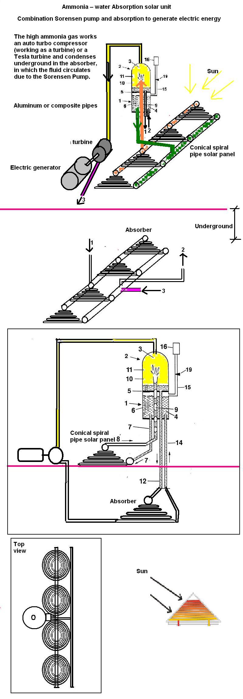

                I looked at vortex tubes for power generation but they are inefficient on the hot side but fairly efficient cooling.
                As always you will surprise us with your device.
                I looked too, in the ejectors, special those used by Denso http://www.globaldenso.com/en/techno...or_cycle_e.pdf to improve absorption power generation and I think that they will. Please see:
                Gas Assisted Solar Absorption Heat Engine

                        Regarding your project here is some info that may help:
                        Bubble pump for refrigeration
                        Ammonia -water properties
                        Solar heat pump generation system
                        Thank you
