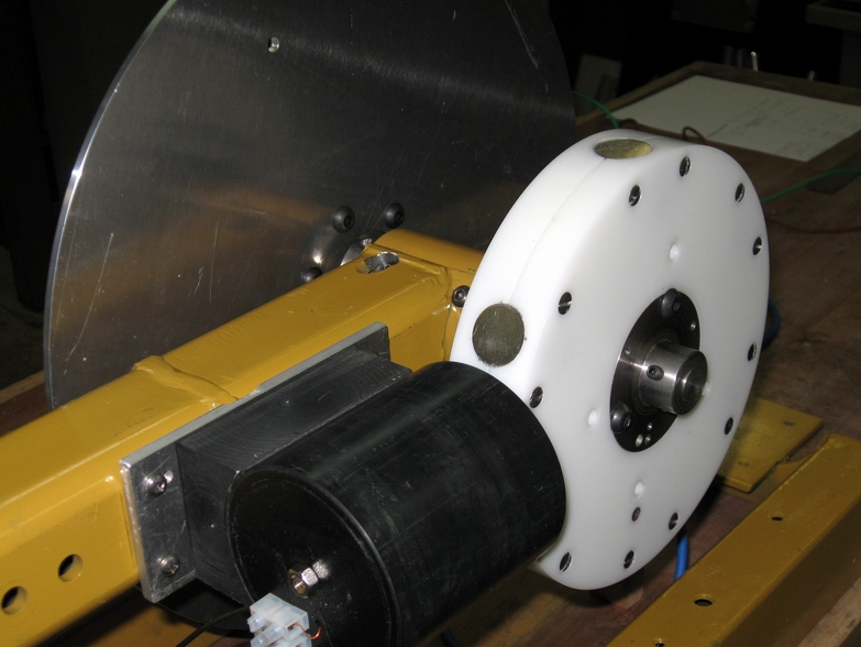

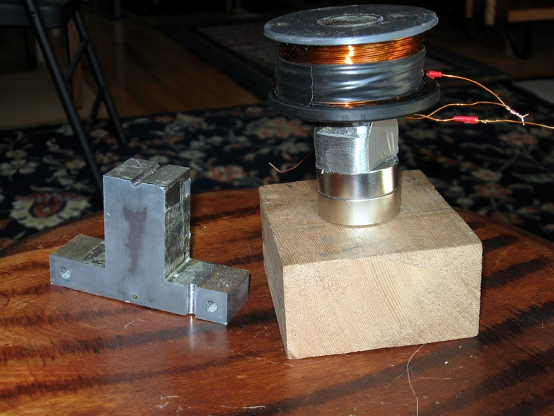

Running 12 volt setup, opto triggered Mosfet, no weight yet, just plain disc...Originally posted by Matthew Jones View PostYou have got it hooked up with the magnet on the bottom of coil or just pulsing regular.
You will get a little more amp draw but that is the trade off for collection. When tuned correctly they will speed up not slow down.
Tell me what you doing exactly and I'll draw you something, and try to get you to the point where you can tune it a bit.
Matt
Coil looks like this (pic 1)
Setup looks like this (pic two)
Ron
Coil is bifilar, .034 wire, 345 turns finish of one to start of two. 3.7 ohms total, both winds. Zero gauss on exposed pole piece at 11.7 volts.Originally posted by i_ron View PostRunning 12 volt setup, opto triggered Mosfet, no weight yet, just plain disc...
Ron
Runs around 900 RPM and .2 amps draw, no diode. Firing about 40%, on for
approach, switch off at TDC
Ron

It is not a solid core, just a chunk of laminated MOT core, whittled down.Originally posted by Matthew Jones View PostI
The other thing is the core you choose I have never tried a solid core like that. I use run of the mill iron welding rods with the flux stripped off. That thing may throw a little different perspective on things.
Matt
I was imitating gap power and only winding half the core.
