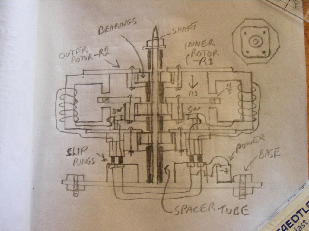

I have a preliminary sketch for a high speed counter rotating device which
uses regular permanent magnets and "C" shaped field magnets however it is
still in concept form and just an idea. It would require a commutator and
brushes though. The design is fairly simple but it would require quite a bit of
effort to construct for high speed, being that the entire thing would need to
be balanced, including coils wire brushes ect. It is a case of bigger means
slower, slower means easier.
Here is the sketch attached.
The slip rings provide the power rails for the coils, the switches between the
rotors could be rotary contact switches or optical devices to provide signals
for microprocessor control. This is a cross section of the basic design there could be
two bearings for the center rotor and the outer rotor's bottom bearing housing is upside
down it should be inverted, or the outer part of the bearing held from both
sides.
This is just a basic design of how a counter rotating pulse motor could be built,
the relative rotational speed will be the sum of the two with respect to the
base. So the required "bearing speed" is halved, more or less. Many other
things could be done. I doubt we will see full effects if the device is pushing
against the Earth to rotate. There should be no rotation "frictional" forces
exerted between the device and the Earth. I think.
The brushes could be on the base and the slip rings on the outer rotor.
The drag from the brushes would need to be "countered" somehow. The drag
between the base and outer rotor could be countered actively by a magnetic
brake of some kind between the center rotor and the shaft, and a
commutator or slip rings could be used as well, if the inner rotor had coils
rather than permanent magnets the coils could be put into a series circuit
with the "C" shaped magnets by a commutator, just as in a universal motor.
Farmhand, is your design based on two coils, or perhaps more?
What comes to using commutators to supply the coils, or more so, replacing them with modern tech switches, could be the way to operate the device at a much higher speed, if needed.
I bring here an idea, that popped to my mind, while reading your latest replies.
It's about that relative rotation, as it seems to be the 'natural' speed/frequency, at which certain sized devices work at their the best.
Meaning, that any sized devices are naturally seeking for their relative rotation, if allowed. And, if all conditions(technical, mechanical, electrical) are met, something special happens.
Just one of my wild visions, that I can't explain any better, no matter, how much I use the dictionary
hi sorveltaja, The design is multi-coil, there should be twice as many outer "C"
shaped magnets as inner rotor magnets/coils, the capacitor plates plus inner
magnets equals the outer "C" shaped magnets/coils. At this point I'm not
worrying about the capacitor plates just yet.
What modern device can transfer power from a stationary element to a rotating
element ? The slip rings are needed, also if the center rotor had coils then a
commutator would also be necessary as far as I can tell.
If the center rotor has permanent magnets then only the slip rings are needed,
no commutator would be required, the coils could be switched by optical
interrupters or optical switches "photoreflectors" The switches I drew inside
the device between the rotors are symbolic, they could be optical switches.
At this point I'm planning 8 outer coils/magnets and 4 inner for a small device.
I think the coils should be switched in two sets, so only two circuits would be
needed. One set on while the other set is off, as the first set demagnetize
over the capacitor plates the second set is pulsed "on". The energy from the
demagnetizing coils would be recovered, possibly directly to power the "on"
set of coils.
I've ordered some optical switches, bearings and such things as well I am
building a microprocessor controlled "switch board" which has four mosfets,
the board could have four separate channels or they could be paralleled to 2
or 1 set. I will have provision for four separate inputs from the optical devices
and there will be two other input/outputs if needed. The chip I chose is a
picaxe 14M2.
I should only need two channels, but they will be there. Even if I were to use
12 outer magnet/coils and 6 inner there should still be only two sets so only
two phases/channels.
I'm planning a device with an inner rotor about 300mm at this point, so overall
it could end up being aver 500mm total diameter just measuring to outside the
"C" shaped magnets.
I forgot to draw it in the sketch but there should be a loop or hook on the top
end of the shaft so it can be hung up for weighing.
P.S. I do have other practical idea's for making the shaft part of the center
rotor so an accumulator can be built into the center. One step at a time.
First I want a counter spinner.
..Last edited by Farmhand; 08-03-2012, 01:50 AM.
