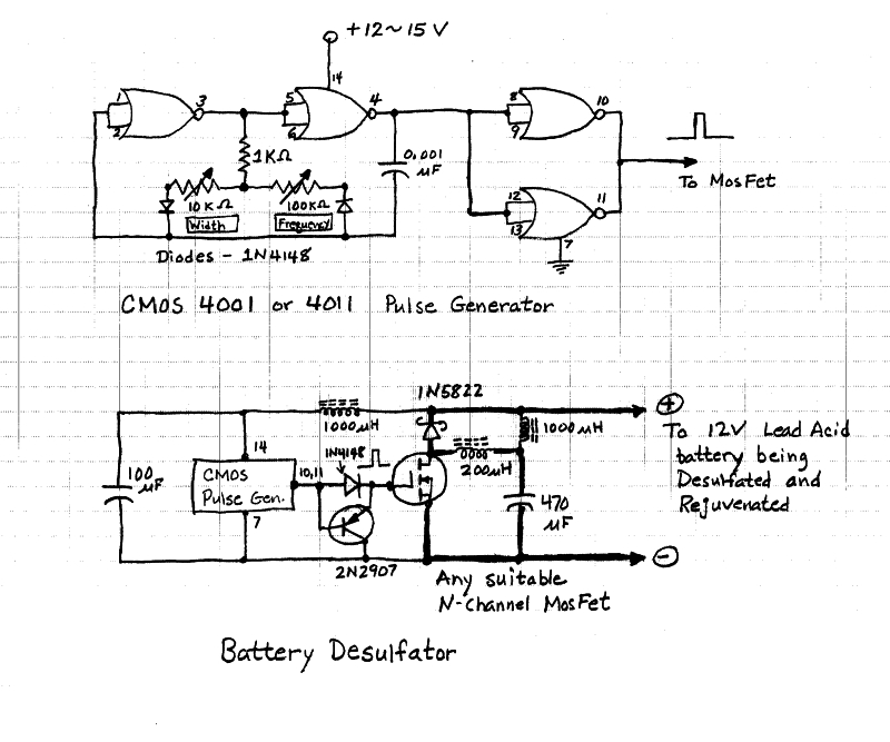

And yes, the circuit starts oscillating by its own just as the switch is flipped. I don't know about the resistance. The wire diameter is about 0.7mm
. However, I'm sure the battery will start to sulfate and start to loose it's charge capacity over time.
I think thats what happens in the setups I have anyway, the quicker the load can disipate the spike energy the less power they draw.
