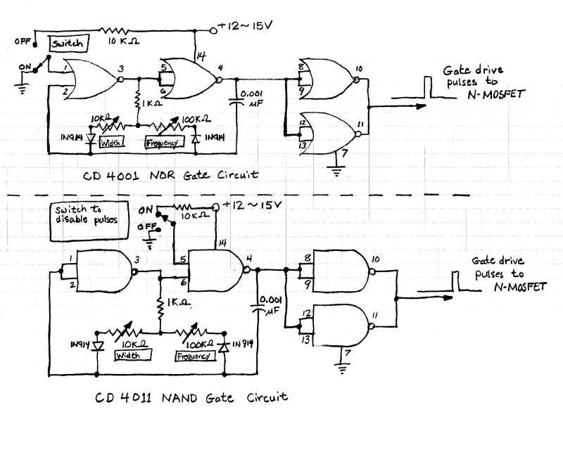

No need to use a pic. Seamonkey's circuit will do the job and the frequency and pulse width are easy adjustable. You will need a scope to adjust the pulses and frequency though.
I will measure the core and wire size for you and also the number of turns tonight just to give you an idea. It is much easier if you have a inductance meter, but they don't come cheap.
One of Seamonkey's circuits is so that you can hook it permanently to the battery. It is powered by the battery and will keep it desulfated. It does use some of the battery power. I think it is a good idea to use with a normal solar charger that keeps the batteries charged.

Can you point me to which circuit you are talking about? I would like to build it.

I've also included a sheet for one of the new high
efficiency transistors which is available from Mouser
for $0.27 each; a tiny surface mount transistor
which is capable of 5.6 Amperes of collector current
with very good current gain - about 100 ~ 250 mA of
base current will take it into deep saturation for a very
low Collector to Emitter Resistance which is nearly
as good as a MOSFET (particularly for low voltage
applications.)

To further reduce the DC resistance of the
inductor wind the 1 mm wire as a bifilar or trifilar
winding and simply connect the wires in parallel.
This will function as a "home made" Litz wired
inductor with very good performance.
There are cases where multiple paralleled wires
will work better than a large solid conductor.
