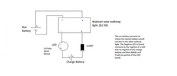

Hi.
Does your Charge Batterie goes hot over Time?
That is, what the Comments at your Vid are about. They think it may will explode, because "You cant charge Batteries"
Usual when you charge with a Joule Thief, the Batteries should stay could,
else they are pysically damaged, or the Duty Cycle is to big.
And what i do see most of the Time is, that the Minus of the Batterie is connected to Plus Suorce.
Its kinda different, what you do show as Setup.
But, by the Way, when i connect a Strobe light to the Leads,
then it shows, that the Current flows in from the Plus Source to Minus Charge Batterie.
So not sure, if it works the Way like you do connect it, with a blocking Diode at Minus, too.Theorizer are like High Voltage. A lot hot Air with no Power behind but they are the dead of applied Work and Ideas.

Oh the exploding thing is just an inside joke with the guy about building custom computers and how some people make theirs look like bombs, it was merely a good poke at me and my mess of wiring.
Everything in the circuit stays cool and quiet. So let me get this straight, when you seen a normal joule thief charger the negative is plugged into the positive?
It seems to work great like the way it is now, but I was skeptical about the blocking diode too but it works.
Have you tried to make one its really simple to do? I keep getting good results, like last night the run battery started with 1.493 and the charge battery started with 1.155 (used a different battery then the original experiment) and shut it off at night and went to sleep and when I woke up the run battery was at 1.489 and the charge battery was at 1.193; I lost .004 but I gained .038!All truth passes through three stages. First, it is ridiculed. Second, it is violently opposed. Third, it is accepted as being self-evident. - Arthur Schopenhauer
Hi,
No, sorry, i dont get the Parts for it, the next Walmart is about 50 Miles from me away.
And yes, usually it is connected from Colector over the Diode to Plus.
--> + -PowerCoil - to Collector and Diode - > + Charge '-' -> back to Plus
...|->-TriggerCoil - to Base.
Emitter to Minus.
Some do connect the Charge Minus to Minus, and it does charge faster for them,
but i would afterwards compare, wich Method gives more Capacity at the Batterie.
I see double Capacity, when i charge them with the Backpath to Plus Source,
and never really tried it otherwise.

They've been running for days without any pop, or any noise, or any type of heat. I think the 100 mV a day is the right way to go because any higher and the battery will pop or leak like you say yours do. And i can't change the coil because there is no coil, it just a simple garden light circuit thats been slightly modified. Plus i don't mind waiting a week to recharge some batteries if they'll last me a month. The low power is key in recharging Alkaline batteries, you can't rush these things to do something that they don't normally do.All truth passes through three stages. First, it is ridiculed. Second, it is violently opposed. Third, it is accepted as being self-evident. - Arthur Schopenhauer
