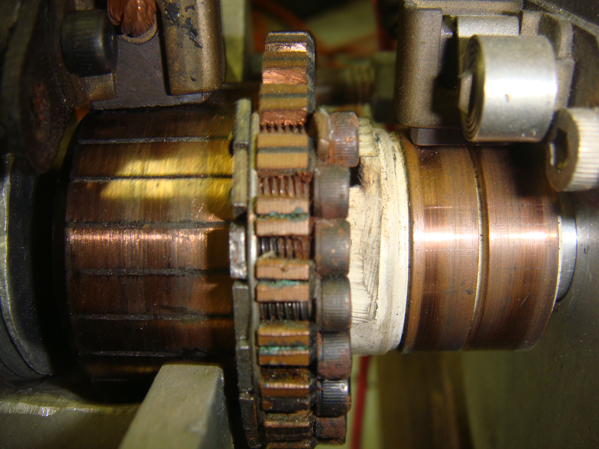

Finally get a chance to take some pics of a comm setup that is very easy to put together and very adjustable. Like I said just mount them both on a shaft and jumper as many comm segments together as needed then connect the slip ring terminal to the segments jumpered together. HTH Wayne
