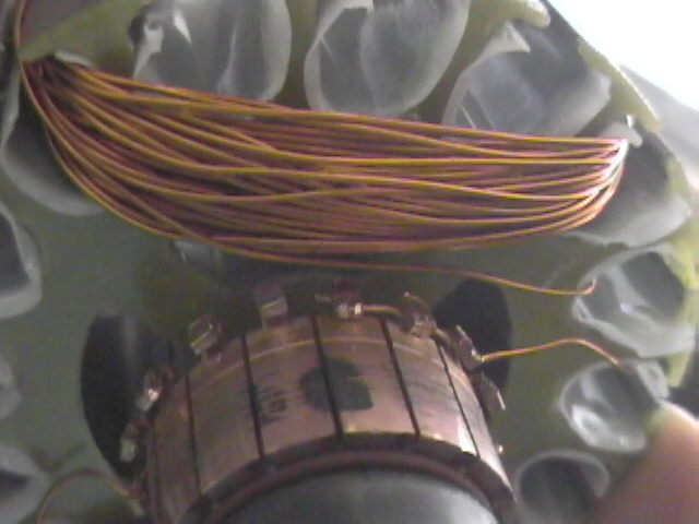

        Also, I attached a picture showing my rotor and the commutator section. The commutator section is burning up pretty badly and I only had it hooked up for about 2 minutes.
        The recovery brushes don't seem to be spaced correctly without modifying it. Have you checked your commutator to see if the same "pitting" is happening?

        • Originally posted by Web000x View Post
          Hey Matt,
          Thanks for the help,
          Dave
          Mine is fine. You may want to unhook the third commutator slot. Since yours is new the recovery and the power brush's might be making a connection and you getting an ARC when they do.

          • Matt,
            I figured out why my RPM's were so low and my amp draw so high. I had put the rotor in the wrong way. The 2 degree offset from the commutators had my motor working against the magnets for a brief moment. Now I am getting much better speeds and lower amp draw.
            When your commutator breaks the power pulse connection, are your recovery brushes instantly making a connection?
            OR
            Do they still have the width of the groove between the commutator slots to travel before they make the connection?
            I visually checked mine and checked with a multimeter. My commutator does not allow me to break the power pulse and instantly connect to the recovery brushes since there is one width space between commutator slots to overcome. I think this is why I am getting such bad pitting in my commutator. Although it is only for a split second, that transient just jumps out too quickly and is really doing a number on the copper.
            I don't think that it is being caused by an arc between the power and recovery brushes. I used a 12 Volt lamp connected to the recovery instead of a battery and still got the pitting going on.
            Please let me know how much commutator space you have between the "break and make" of the switch. Until then I'll just keep scratching my head.
            Dave
            • 3 commutator spots, usually breaks the connection just as it makes connection to the recovery. So there is just a little time off. If they both were making connection to each other your amp draw would go up to probably around 6 amps and you would see above input voltage coming out of your recovery side.

                • Matt,
                  It definitely isn't making a connection between the power and recovery brushes so that can be ruled out as a source of arcing.
                  That first picture that I posted a couple of posts back showing my commutator damage was a result of a bad connection. There was still too much enamel on the magnet wire connected to a commutator slot. This was causing the inductive spike to discharge one full commutator slot too early so the spike never made it to the recovery brushes.
                  After I fixed that problem, I still had signs of pitting, but they were not as severe. It is still too much of a problem to ignore.
                  So you have absolutely no wear on your commutator using this setup?
                  If you are not seeing any signs of wear, I am thinking that it may be that my brushes are too new. They have not completely worn to the shape of the commutator. The edges on the arc of the brush are still slightly rounded.
                  How are your flywheel and prony brake coming along?
                  Dave
                  • Get a chain saw file and reshape the brush's. That might help.
                    I suspect mine might get a little black over time but there is no noticeable wear anywhere else. But then I haven't taken it apart. It runs fine so no reason too as of yet.

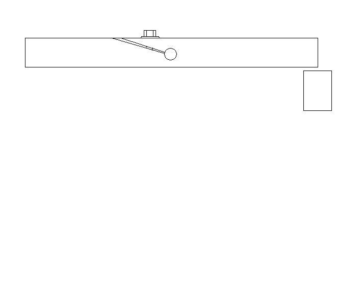

                          • Measuring torque
                            Simple accurate pony break.
                            Get a 2 foot length of 2x2, drill a hole in the centre the same diameter as your shaft. Make a diagonal cut from one side to the hole. Place a bolt through this split to tighten it on the shaft. A second bolt can be placed on the opposite side to balance the weight.
                            Once fitted to your shaft adjust the bolt to get the required speed on your motor and read the torque on an accurate electric balance
                            • I really appreciate your feedback!
