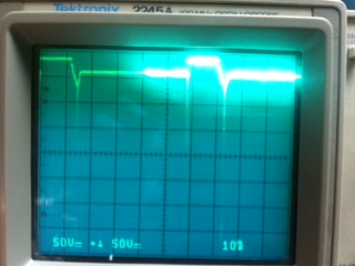

We have a great increase in voltage on the unconnected winding.
what your trace does show is there is a transformer action. Put a low impedance load on the disconnected coil and shorten your pulses by 2/3rds.

Take a close look at the FEMM drawing,there are a lot of clues in it. The red coils are the input and the green is the output. if the other two white coils are used' the 3 o'clock is powered and the six o'clock is an output. If you don't split the case you will only be able to use 2 stator coils and it will not perform as well. the black boxes represent the location of the carbon brushes.
With my design we have transformer and generator action in our output coils but I have not seen a scope trace yet.

. My brushes are spaced a little less than 1 commutator segment and the diodes I am using are in motor NTE 598 600V 8A ultra fast and on recovery batteries UF 804 same specs I think. I have recovery side diode on a clip lead going to recovery battery positive. Highest I can go right now is about 34V, still notice the spike there, maybe if I go faster, things will change?
