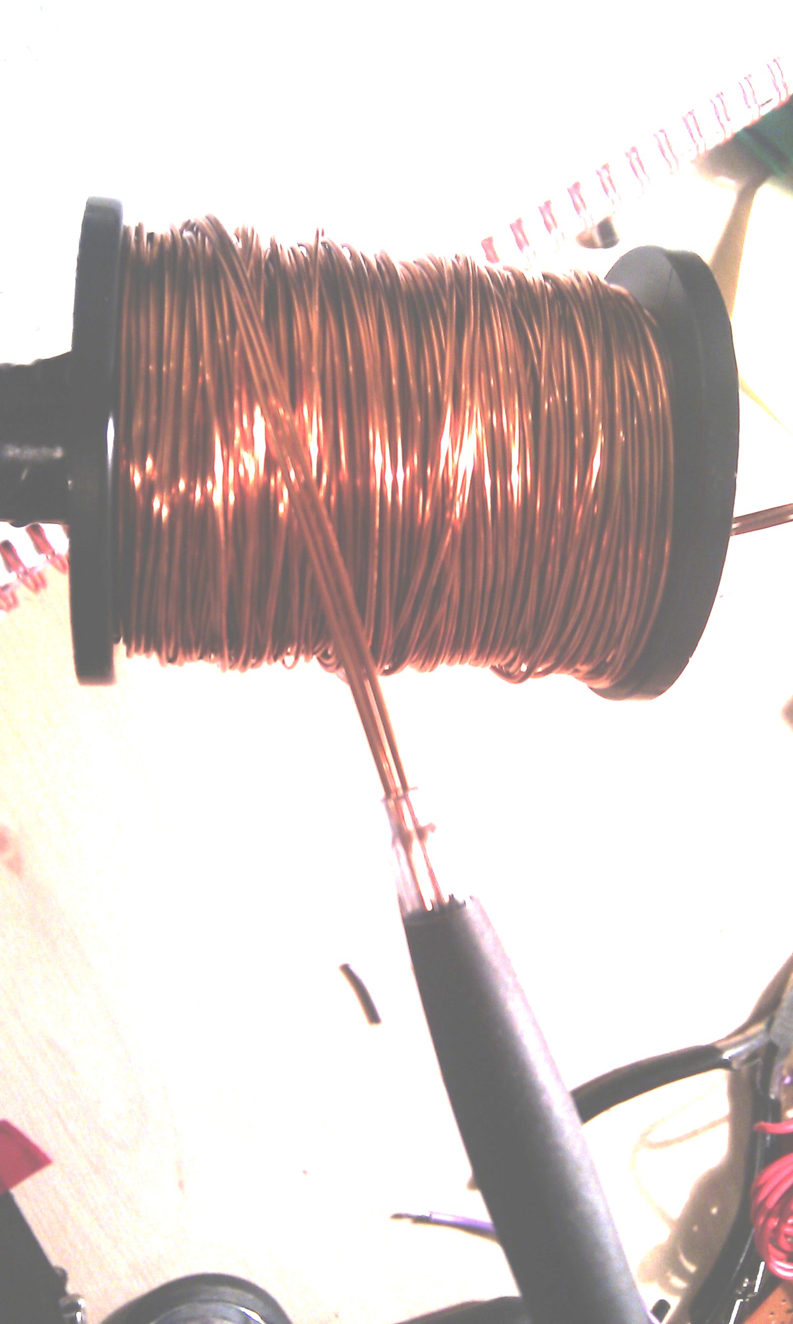

      Just an idea. I wound a multiwire coil yesterday and I did not want the wires separating much on the coil as seems to happen. I fed them though a biro with the inner bit removed. Hold the end as a pointer close to the coil and hey presto... nice neat coil.... and no expensive winder, spools on a rope feeding through the dismantled pen and the coil being driven by a high torque low speed cordless screwdriver

          mmmhh.. I have a video camer (old) and need to figure out how to get a film off (dont have firewire on my new computer or laptop). Probably won't wind another coil till later in the year as I need to build the new rig first - just about worked out what I want to do. I will however endevour to botch some footage up when I do.
            Not the most dazzling of images ..s ... low light and a dodgy camera. Hopefully you get the idea clear enough.
              Faramog thanks for the image.
